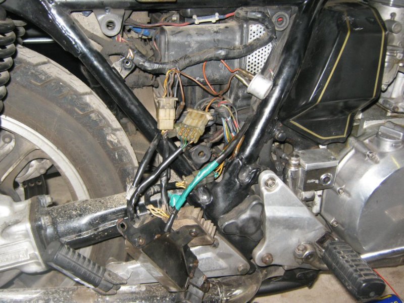

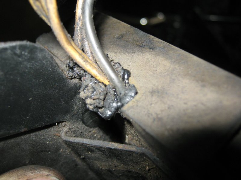

Ok looked at it again, it was still running like shit, decided to check the black wire that goes to the #1 + #6 coil from the igniter connection plug, found more stuff wrong than I did before, regulator seems to be stuffed, plug and connectors bad and the rubber insulation where the wires go into the regulator body soft and melted looking, thank goodness I have a spare, swapped that over and fixed the plug cause the one on the new one was really good. Anyway the wire to the coil is ok, I sort of know how to use a multimeter to check for a broken wire, and after fixing the regulator it seems to run better, checked the charge to the battery and it is also good, charges at revs, still have a bit to look at, stick some insulation over a plug from the igniter as I swapped the whole unit and that one isn't a good one, did a rough compression test and it's not good either but it should still run. I should just give up, but i'm a stubborn old fart, but it might take a while, so anyway i'll stick a few photos here just to show I did do something, even took a shot of the "old/new" coils in place, wish me luck and thanks to all for offering suggestions and tips, keep 'em coming as I need all the help I can get
, hey ???? would the stuffed up regulator and plug be causing any of the problems I've had, I haven't taken it for a run again yet but maybe she was running off the battery and power got low or the regulator was shorting and causing problems ??, i'm clutching at straws here but i'll try anything
, cheers Pete.
P.S. there is a brown wire hanging there with a bit of green insulation tape around it, any idea where that goes, don't think it was connected to anything, i'll try and check in the manual wiring diagram, just have to find my magnifying glass
Please forgive the condition of the bike, she is an old warhorse and daily ride, she isn't any show pony that's for sure

Looks like you're making progress, so Kudos to You! It seems by your description of the situation that you have multiple issues in two circuits. Charging and ignition. Any time you see encapsulating material erupted from a housing it indicates excessive internal heat. My opinion at this point is (based on your descriptions and pictures of the V/R and the connector plug) is that the corrosion of the plug caused high resistance, eventually burning out one or more components in the Volt/Reg. The Voltage regulator should be considered "Toast". I wouldn't trust it at this point even IF it did "Test" OK. It sounds like you've addressed this and can move on to other concerns in the circuit. NOTE: Once you've got things sorted-out you might consider removing the V/R-Alternator-stator plugs completely by soldering and heat shrinking the wires together. I, along with others have done this. I burned out 3 stators before doing this. The 4th is still good after about 26 years. Because you ride daily and likely do so in some wet weather - this may be more of an essential change vs an optional one. Lucky you had another !
An educated guess on my part would suggest to you that a 'stuffed" V-Reg would affect all ignition coils - not just 1&6.
KB raises another good point about arbitrarily replacing components. In your case with multiple concerns I would address all the potential connector and wiring issues to ensure the best continuity which will ensure maximum voltage and current goes to where it's supposed to with the least amount of resistance. Once the wiring is addressed and proven intact you can plug in the electronic components with more confidence. It is very possible that you have corrosion behind a terminal - inside a wire(s) insulation which could mean high resistance or intermittently "open" circuit ! This brings us back to KB's point about using a reliable/trustworthy meter and having the confidence to understand the readings it display. Lots of info out there on how they work. "So simple even a Meat-cutter can use one !
A corroded/broken wire inside it's insulation can be all but impossible to determine without a meter.
If you keep persisting as you are then through the simple process of elimination you're systematically eliminating the faults and one by one going to solve the ignition problem. Hopefully your #1 & #6 problem will be a "connection" issue and won't require a replacement ignition controller.
