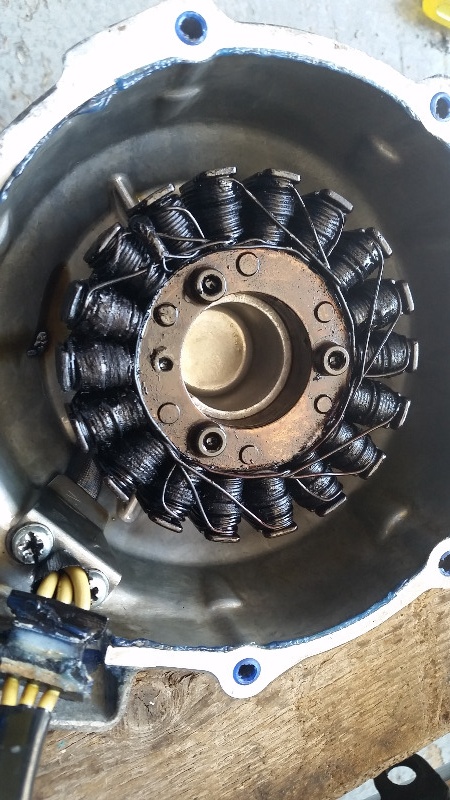

Took off the cover and found one very fried stator. Burnt to a crisp.
Also found no gasket and some blue locktite type stuff so I'm guessing this isn't its first stator. It wasn't leaking oil which shocked the hell out me.
I'm running with the assumption the R/R is what is frying the stator so I am dropping the other one in.

Sounds like you've got it sorted out. If I can suggest : Use a gasket ! I don't like the potential of cured chunks of RTV sealer getting into the oil system.
