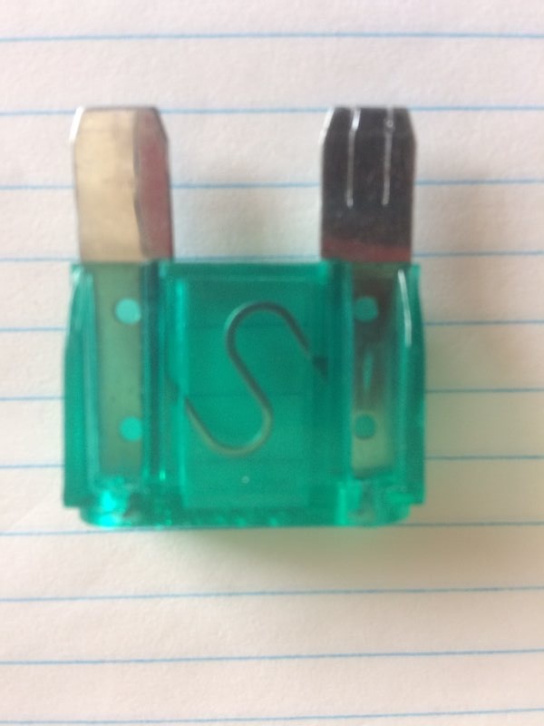

This is the fuse supplied with my V/R

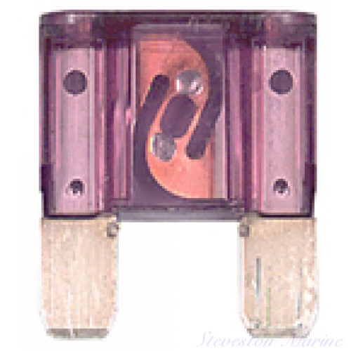

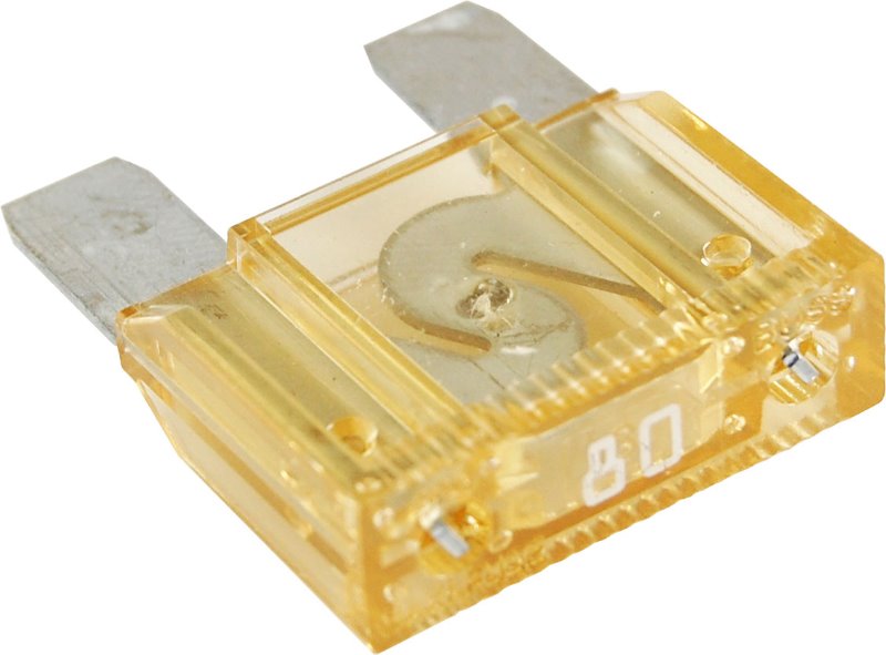

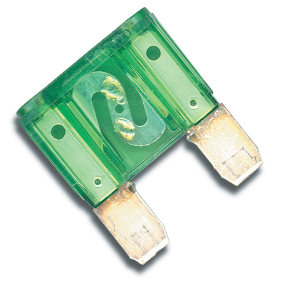

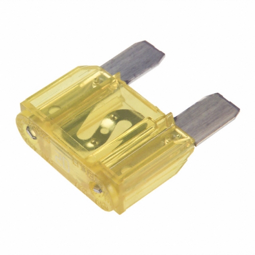

The following are Maxi-fuses. The difference in the elements is obvious.
