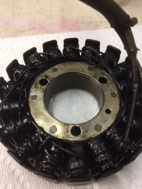

The photo is of the stator I replaced. Looks fried despite having good continuity between the Yellow leads and there was no short/ground to frame. However, One phase was delivering about 30 % less A.C. then the other two phases so decided it prudent to replace the stator while installing the new MOSFET V/R.

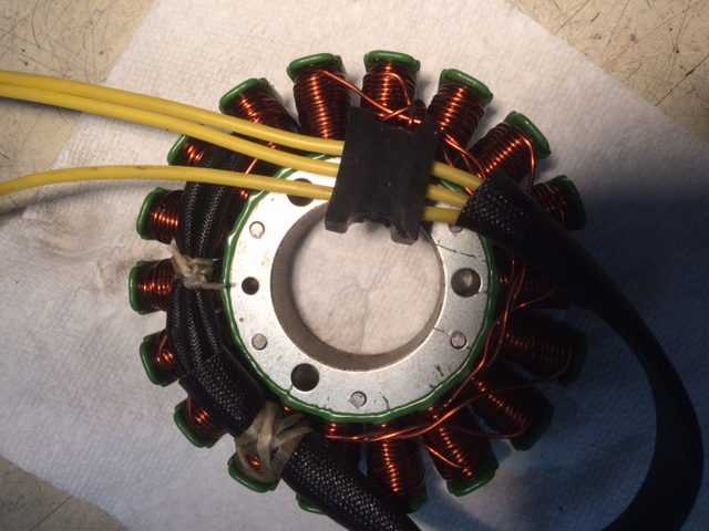

Upon inspection of the old stator I discovered a small piece of nylon tie-wrap stuck to the leads! The new Stator came with 3 Ny-Wraps securing the leads to several poles. I removed them and secured the leads with proper winding tie-cord. Why would anyone use Ny-wraps for this? Faster production assembly and cheaper then taking a few extra minutes to secure with traditional electrical winding binding! Can't say one way or another whether having the leads moving and vibrating after the Ny-wraps failed caused the issue, but it's a good likelihood. Cheap bastards, regardless ! Using Ny-Wraps in this environment is just stupid, in my opinion !
New Stator with the original grommet installed. The grommet was pulled off the old leads and installed on the new ones relatively easily.

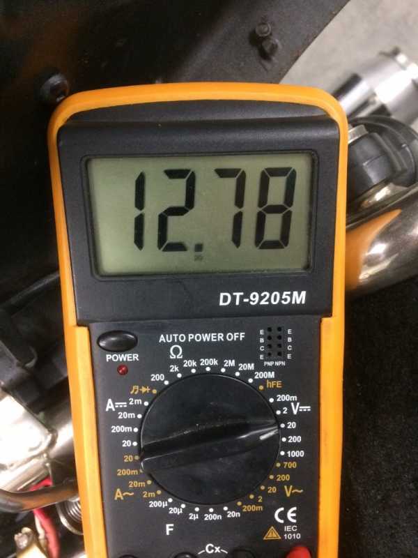

Battery at rest

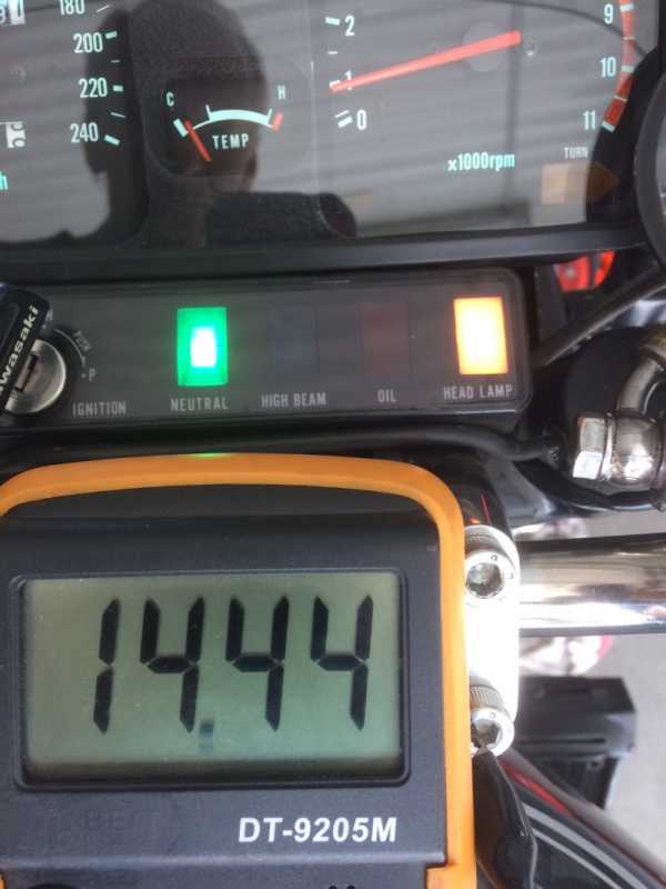

Charge at idle - No headlight

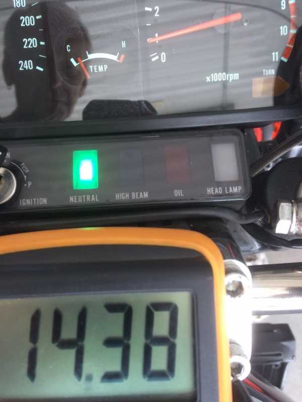

Charge with Low Beam

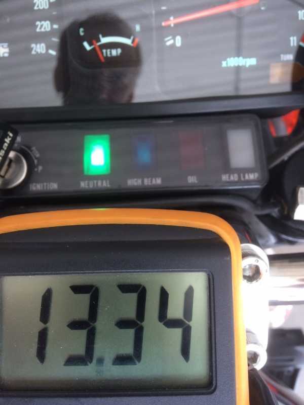

Charge with High beam PLUS 55W driving light
