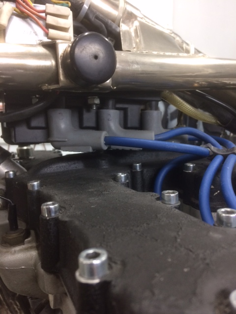

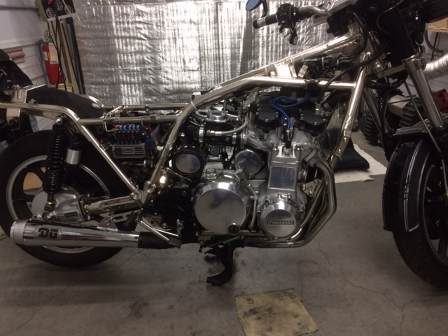

With the tank off for some recent work, I took a better picture of the coil-pack. Pollution reed-housings have to be removed.

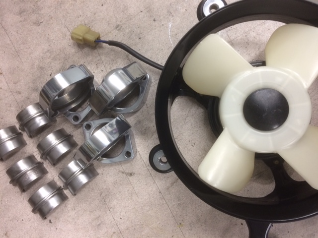

I cleaned up the previously polished header holders. They had flow-marks from being cast so I used a sheet of 400 wet paper on a flat surface and removed those marks, then repolished.
Cleaned the Fan blades and shroud and gave everything a good layer of Paste-wax to slow down the accumulation of grime that inevitably collects.

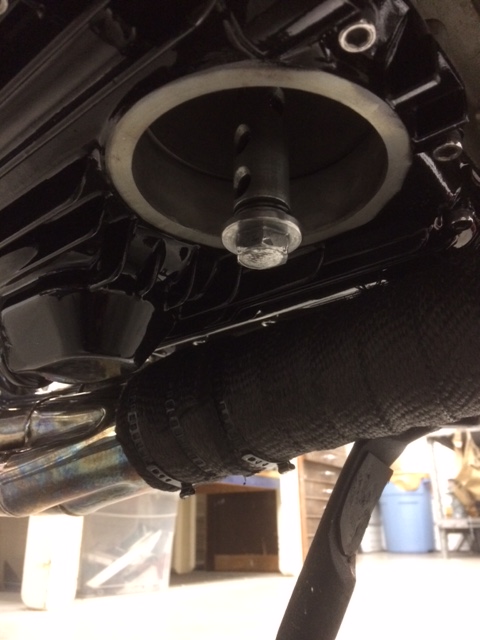

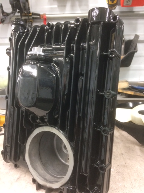

Painted the oil pan after glass-beading the outside. Not concerned about the coating "insulating" the pan and preventing heat dissipation. One could debate this topic from the point of view that with a massive collector within 3/4" of the pan, the collector puts more heat into the oil then the cover could ever dissipate which is why I chose to double-wrap the collector.

Now I will be on a lookout for that black cap you have on your fan. Did you find it at Home Depot or Can. Tire? Great idea!
I also use 400 then up to 1600 paper on a flat surface to make all the different housings sealing surfaces flat and perfect.
I agree. I am not concerned with heat much when it comes to the oil pan as well (and I also see you year looks quite different than what I have).

Stan: The black plastic cap that I have on the fan blade-center is a generic cap which I just happened to have. It inserted well but being "plastic-on-plastic" and inherently slippery, I put a drop of Loctite on it just to be sure it stayed in place.
I did a thread some time ago on the GM coil-pack conversion. Search: "GM coil conversion" This particular coil was from a Pontiac Grand Am and its primary resistance required the inclusion of the stock Ballast resistor. Personally speaking I had no issue with retaining the resistor and I've had no problems or concerns with this set-up. Again - personally speaking - I don't see why some have an aversion to using the resistor if required. Of course if a retro coil-system meets the resistance requirements then YES, the resistor must be removed. Having followed your progress and understanding your level of aptitude, I can say with some certainty that you'll not have any problems making the correct connections - with or without the resistor if this is what you're considering. I had to drill four additional holes in the OEM coil mounting plate to accommodate 4 of the 6 holes on the coil-pack. The mounting holes already in the GM coil can be tapped to take a metric bolt or screw. There is an obvious need to have an electrical insulating medium between the terminal side of the coil and the bottom of the mounting plate. I used a heavy piece of Gasket material.
With the header-collector "double-wrapped" you can actually touch it. It gets very warm but won't burn. You can appreciate how much cooler this keeps the oil! About 8-10 degrees C. by my oil temp. gauge.
Truing surfaces on a flat surface with a sheet of the appropriate type and grit works very well as you have re-iterated.

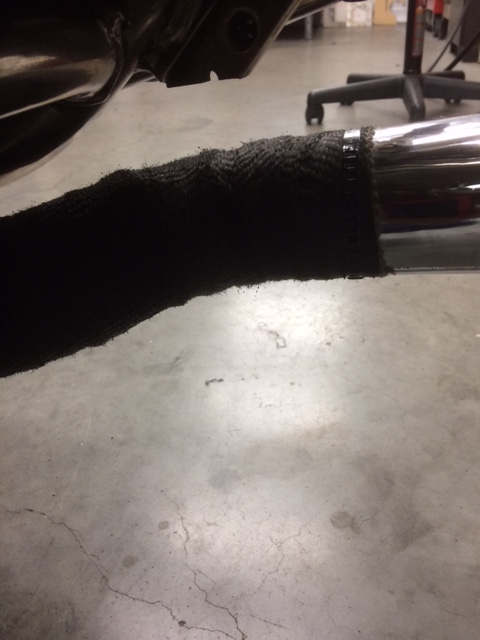

Could you post a photo of your header collector wrapped? Did you paint it before wrapping?

Re: Header-wrap. Just the collector. Too much controversy about wrapping the actual down-pipes.

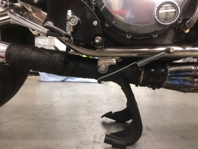

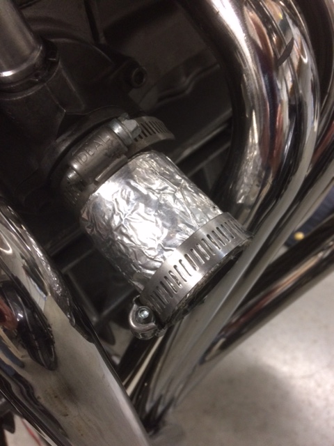

About the "Small details" - I wrapped the water-pump inlet hose with 2 layers of 6 oz. fiberglass cloth and then cover it with 2 layers of foil-tape.
Look at the center-stand closely in one of the pictures. A mod. I did so I can use the center stand with a DG.
www.kz1300.com/index.php/forum/suspensio...r-stand-vs-dg-header
And a picture of what it looks like naked.
