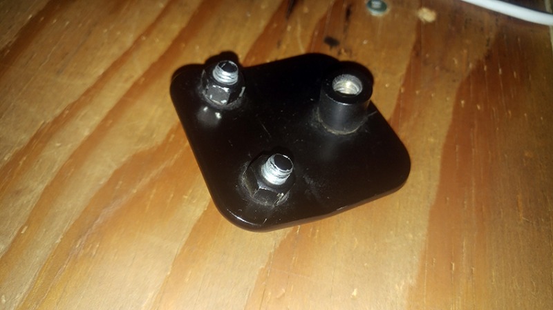

Thanks for the link Kawboy! This confirms that the headlight I got is maybe A1 or 2, because it's identical to those in the photos. I wonder if A4 is the same.
One thing - it came with this pictured below bracket, which was attached to the bucket on top of the conical rear compartment where all the wires go. I am not sure what's this for, but it is in the way so I removed it and will plug those two holes.
