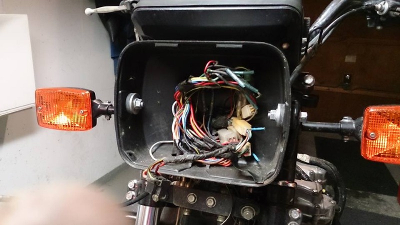

I got this photo from someone when asking a similar question, and I bet he wouldn't mind me re-posting it. I am still battling the same exact thing! The place is very cramped and confusing. In general, I don't understand why the wiring has to always be like a bunch of seaweed pulled from a beach!

Thanks Stan that's a great picture of the wiring, looks like we just have to 'force' it to all sit around the bulb connector and (I suspect) a bit of "crush it in place when reassembling" !!
Next thing is to figure what goes through upper and lower holes in the shell and what effect that has on the lower loom run.
Fun fun fun!
Thanks again.

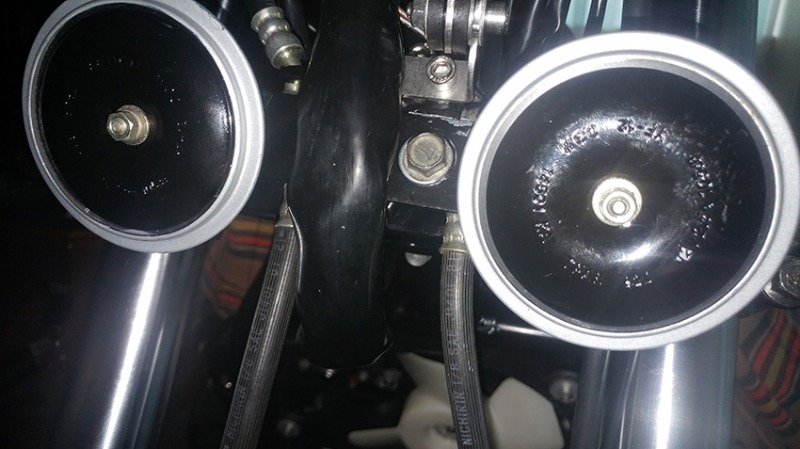

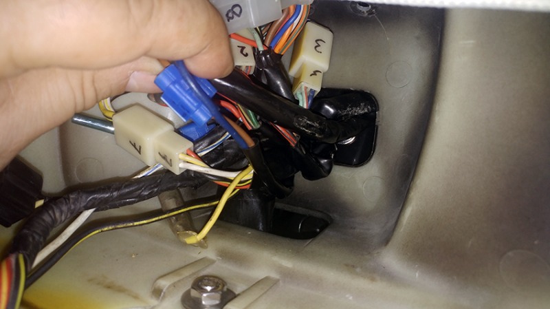

Based on the info I already gathered, here are two photos of my current state of headlight affairs.
The main harness comes up from below between the horns. It enters the headlight bucket through the bottom hole, the wires from the ignition and all the others coming out of the speedo unit, enter through the top hole. They are connected inside, then comes the 'nest' forming... The bottom nut is the one connecting the bucket to the headlight bracket underneath (had to buy it as well).
My bike came with no lights at all - headlight, tail, signals etc., so all is new to me as well. I still need to figure out how to connect the front turn signals. I don't see any wire bundle pointing to them from the harness - I might have missed something and need to investigate it more.

Perfect pic's again, you're spoiling me!
I'm in the workshop tomorrow so I'll ID the indicator wire colours and where the route from, hopefully then you can trace back and see if they're there or been cut back etc.
Your 2nd pic suggests my back-shell isn't the Z13 one, mine has massive cut-outs for the loom, literally about 40% of the back of it, and they look original moulded edges etc.) so it's maybe a GPZ one.
Thanks for confirming on the route of that lower loom bundle, makes sense too (to avoid the log-jam behind the headlight) so I guess once I figure out how much of it lives inside the headlight I'll then have to see if the 'spare' needs shunting back along the frame.
My coil connections look to be in the right place so that looks like the limiting factor in loom position, at the front at least.
Thanks again for the quick help and good knowledge.
