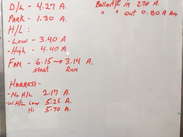

With the upgrade recently to the MOSFET V/R and some work on the signal-cancel module (re-soldered the entire board and all connections and it now works) I became curious about the various current draw on some of the circuit's. I made some test leads to fit spade and bullet connectors and recorded these numbers from my digital VOR meter.
So for what it's worth:
55W Halogen Driving Light powered directly off battery via a relay triggered by high-beam .............4.27A
Park Lights .......................................................................................................................................... 1.30 A
SYLVANIA H6054 SilverStar High Performance Halogen Headlight ..............................Hi-Beam....... 4.40A
Low Beam..... 3.40A
Fan ...................................................................................................................... Start current ..........6.15A
Run current ........3.14A
Electrical harness (BROWN) No Headlight ........................................................................................ 2.17A
Headlight LOW ....................................................................................... 5.25 A
Headlight Hi-beam ................................................................................. 5.70A
Ballast Resistor (engine running).........................................Power IN…………………………………… 2.70A
Individual PINK ........................................... 0.80 A
