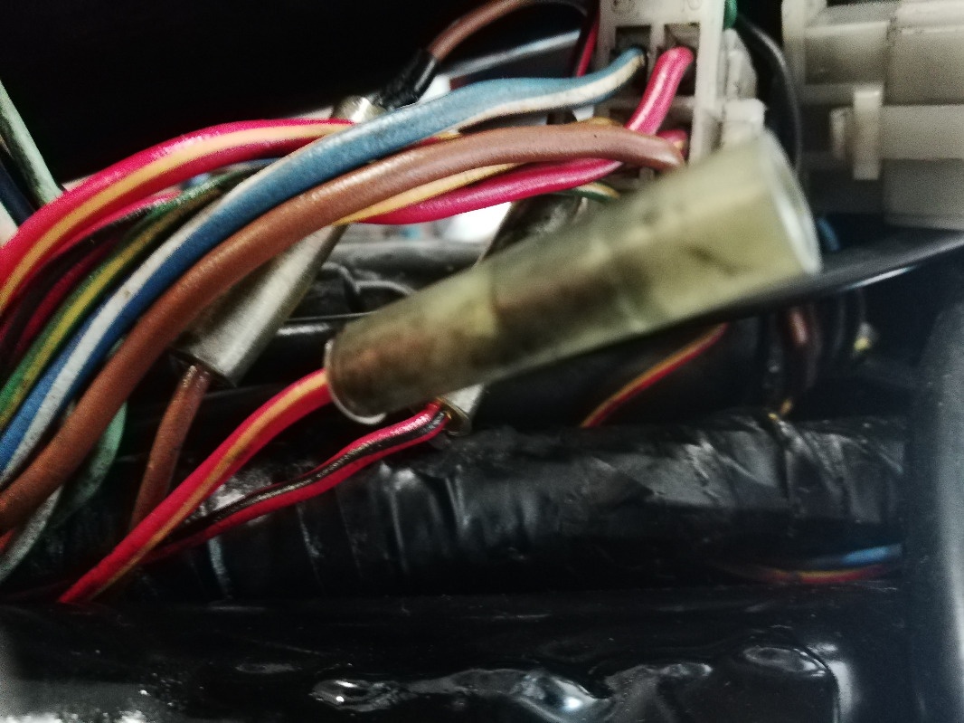

Hi there,
Anybody knows if this red/yellow wire has any correspondence ?
It's in the coils area.

Looking at the wiring diagram, it looks like the red wire with yellow tracer is either the low beam or high beam feed wire for the headlight. If it goes into a 6 pin connector on the other end of the female connector you show in the picture, then that female connector marries up with the headlamp bulb.

Thanks for your help Kawboy !
That's it
