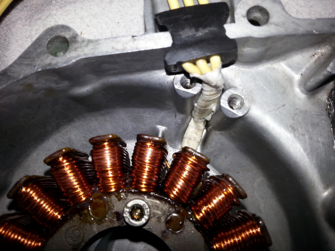

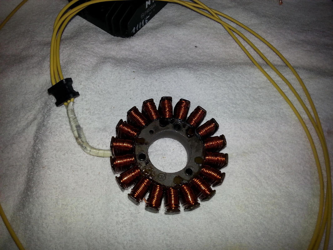

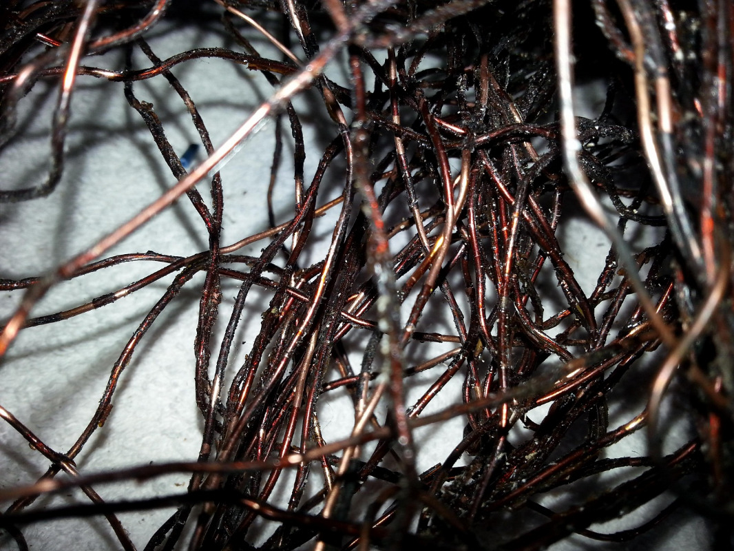

My generator stator burned out, obviously shortly before the weekend, so the only way to fix it quickly was to rewind it my self. I couldn't find any info readily available so I post one now. Quick check in the box with my old tube amp building materials, copper wire is there, some isolation tube and fiberglass tape so I was ready to go. I've made a measurement of the winding and they where well out of spec, or better to say complete out of space. After dismantling alternator cover it was instantly clear (from the smell of it) that the winding insulation was gone. First step was to strip old wire of the stator poles and clean everything, also sanding down any sharp edges on the stator posts. The job is not very inviting but its got to be done, and of course counting the turns is vital. 37 turns pro post, wire thickness 0.9 mm without the insulating lacquer.

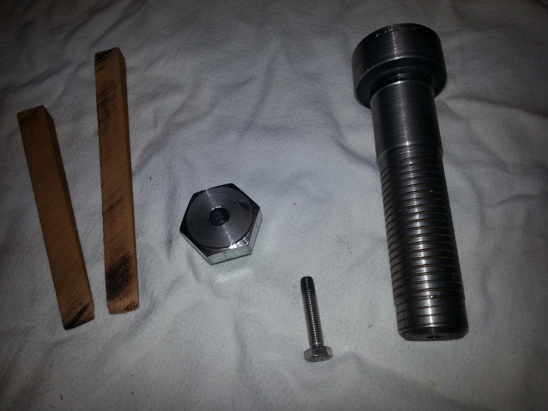

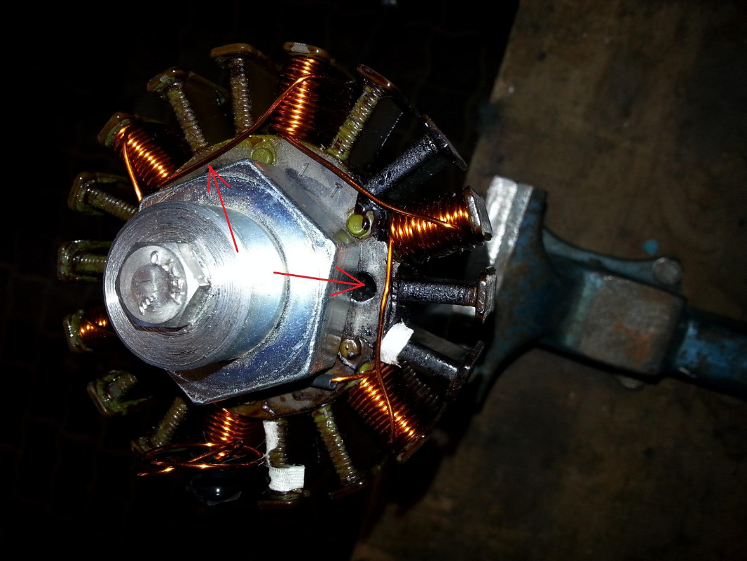

After that, is going to be easy. I've made some tools to do the job. On the late I turned down thick bolt and made the thread in it so I could attach my stator to it and fixed all together in the vice, because of this, you can pull hard on the wire when making turns so you can wind it “tight”, if you don't do it, will create different problems later.

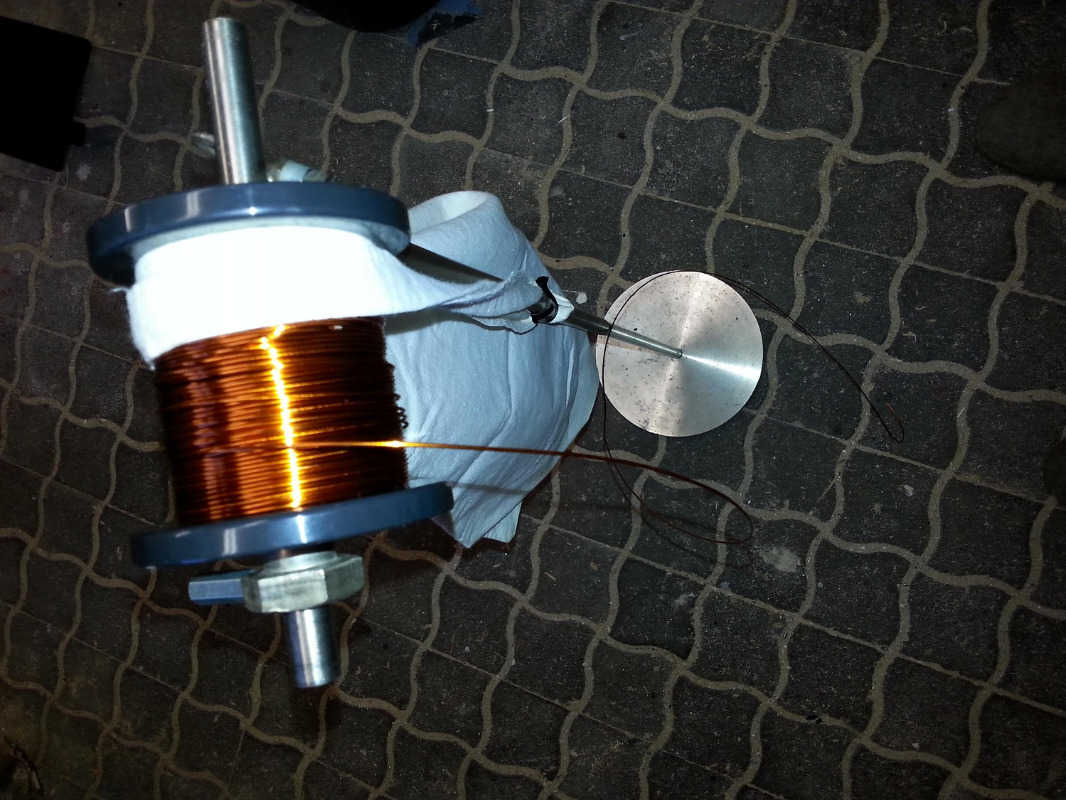

Above, the tools needed for rewinding job and below the wire stand.

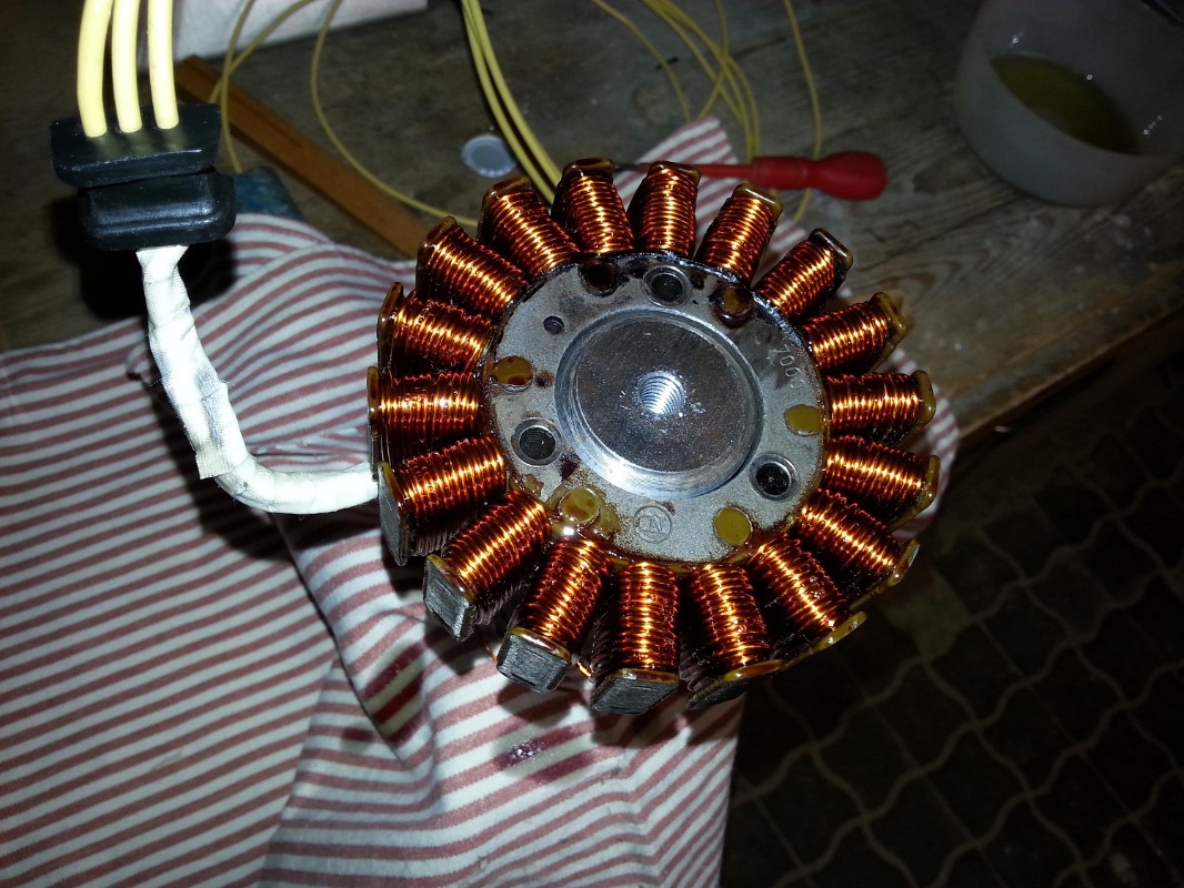

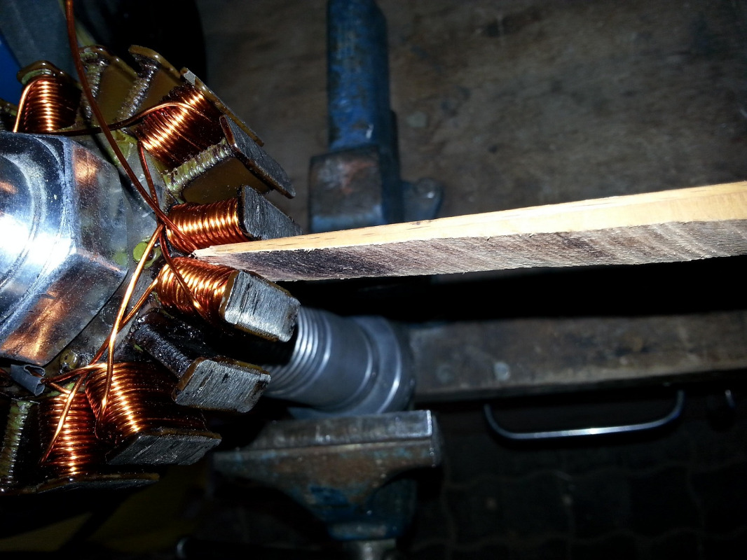

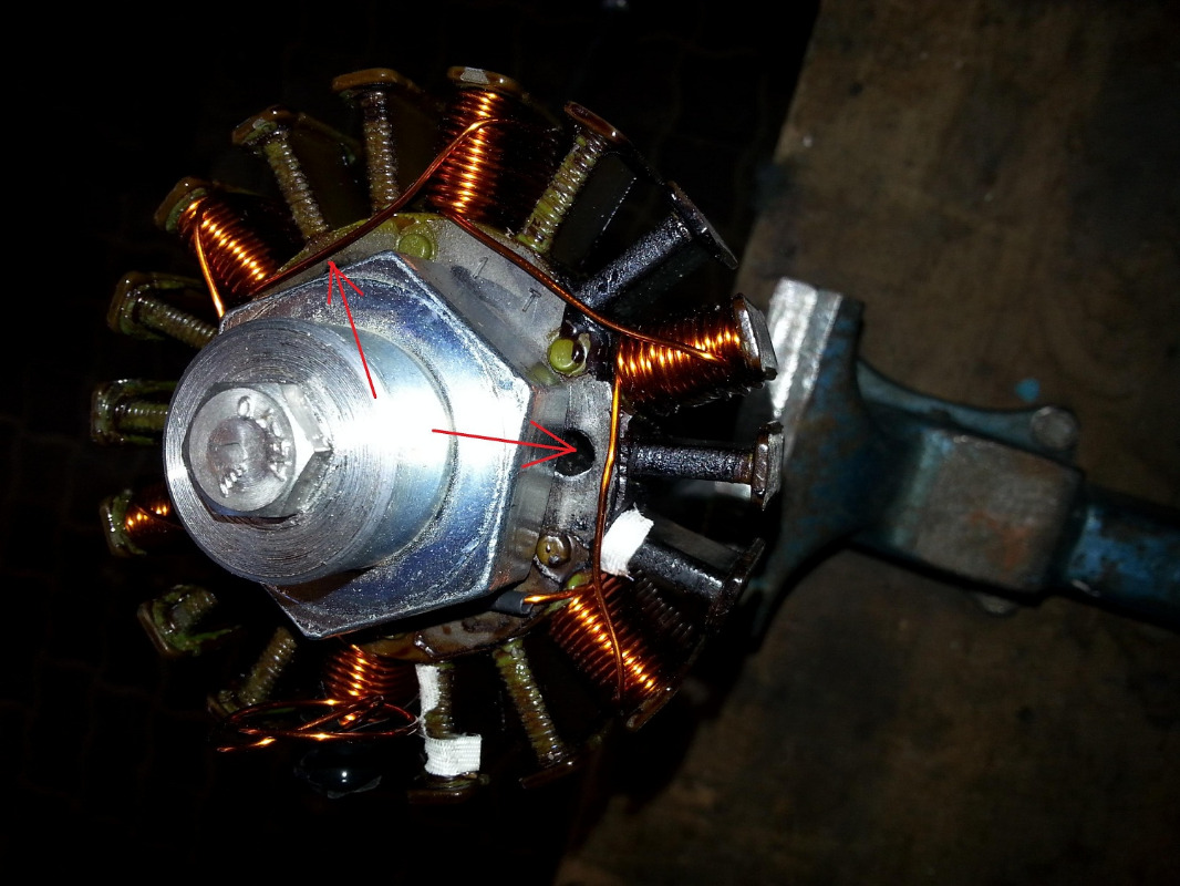

Than I mounted everything in the vice and started winding first of three sections. I'm using here 0.95 mm wire. Important is, that the inter connecting wire is long enough (picture below) so you can bend it towards outside so it want create problems later when mounting stator in the cover on to the supporting posts. Here, you see the side which is going in (down), towards the cover when assembling.

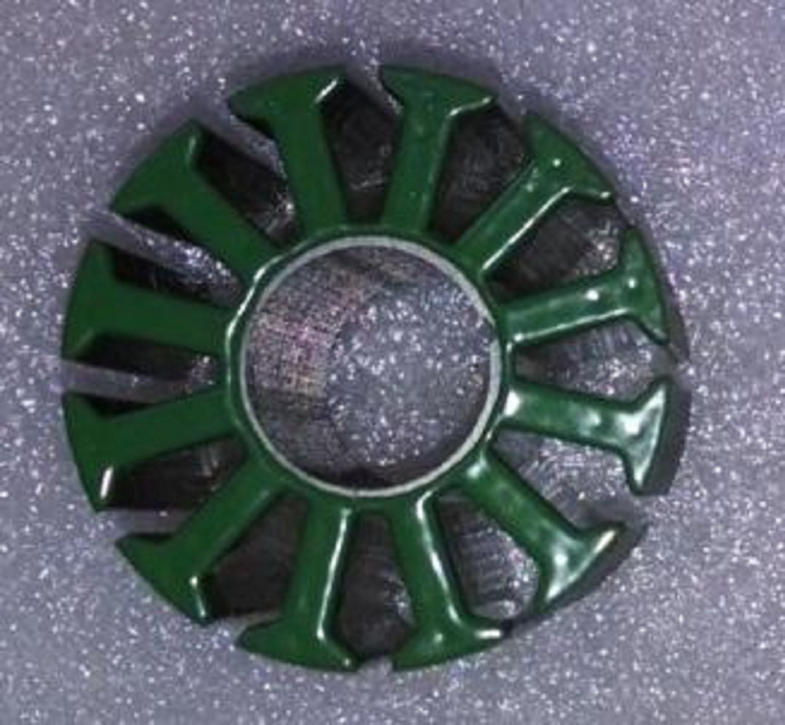

The green isolation paint has turned black because of the heat of windings being shorted and conducting electricity but I decided to leave it on, NOT PROPER JOB, if you doing it right it should look like this:
Above, picture is showing green protective paint layer so wire insulation won't get cut through on sharp stator edges. PROPER JOB.

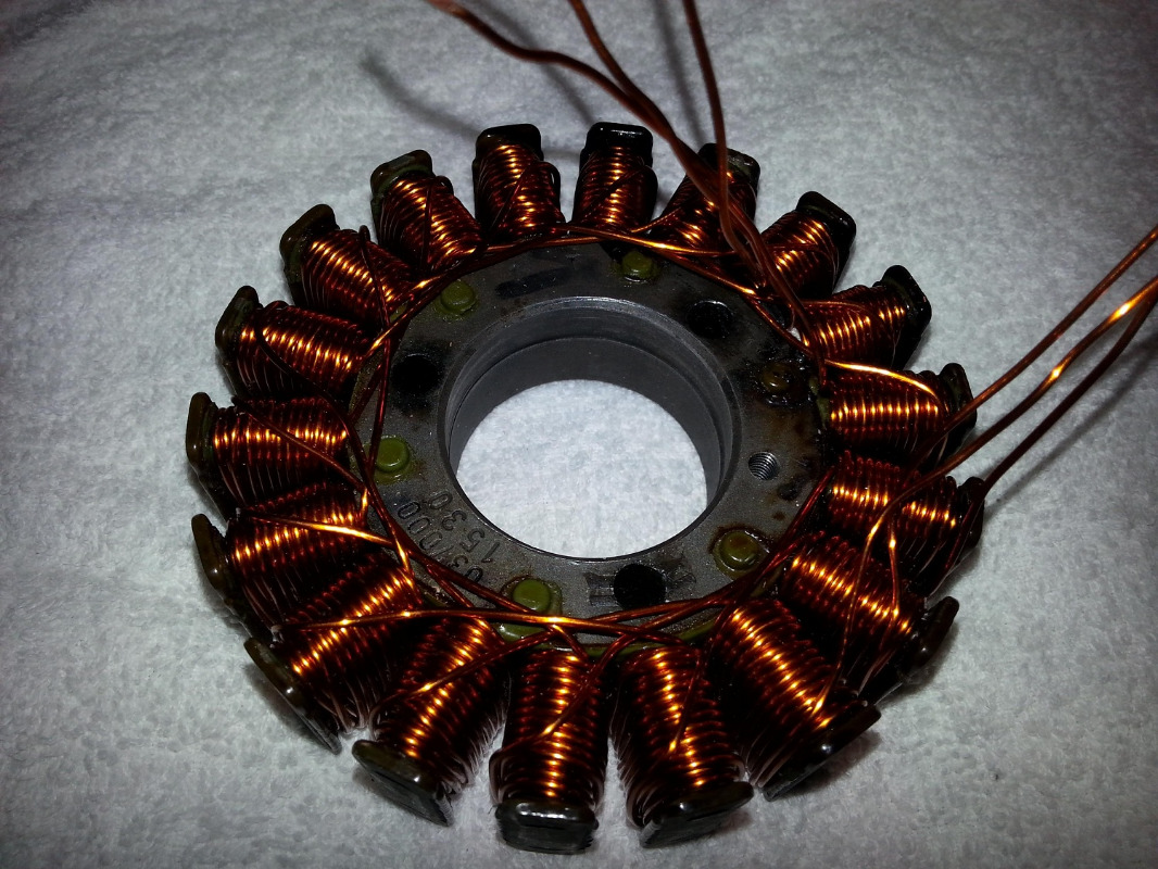

Piece of hard wood helps “compressing” the winding turns, I press them every 4 to 5 turns. There is not a lot of space for the wires but probably enough even if you use 1mm wire which would give you some more current, probably only marginal, but you still moving generator output power towards more, instead of less, when using thinner wire.

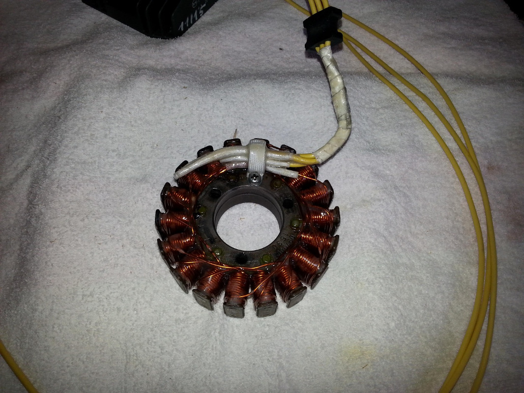

And here all the windings are complete.

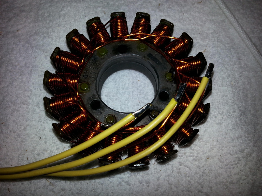

Next wires are being soldered together, three phase connection in star.

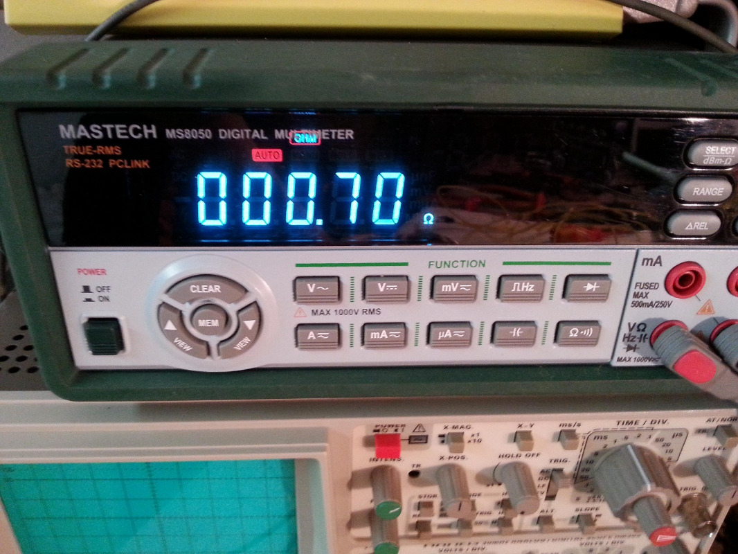

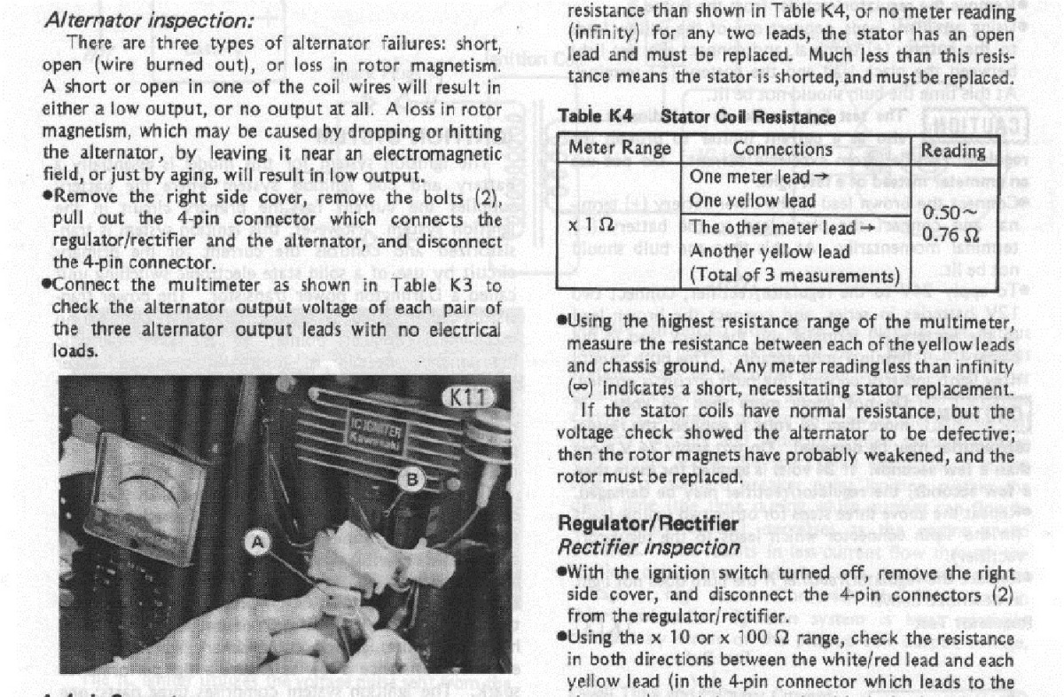

Measurement of the winding resistance, everything looks good.
The manual says, the resistance between two yellow wires suppose to be between 0.50 and 0.76 ohm.

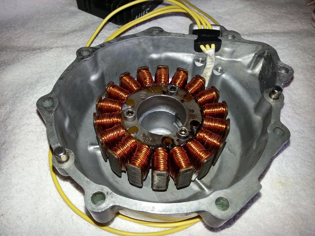

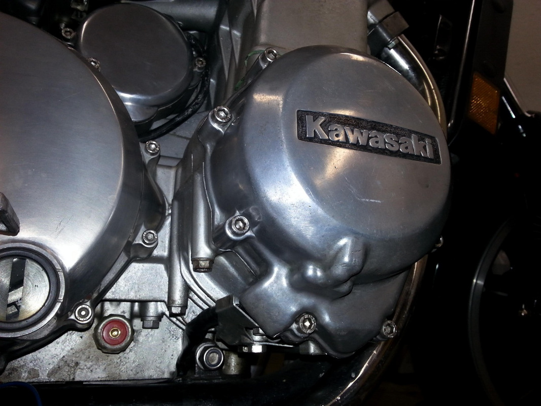

The next day everything was cured so I started reassembling generator together again.

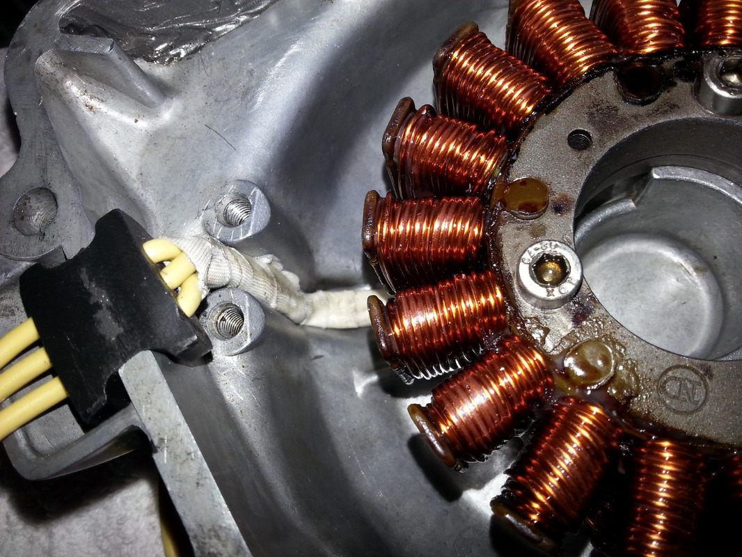

Its also important to place the cables tight in the channel and also deep so it does not get cut by the protecting shield which has a tendency to stick too far out towards the rotor on the bottom and rub against it.

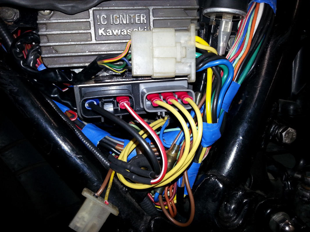

Now with everything in place I started the rectifier upgrade job. I got one before the alternator failure of off E-bay and it was listed as, from Yamaha MT-09 Year 04.2015 Rectifier Regulator. Its a Shindengen FH020AA.
This is only a quick job on fitting it because I'm planing on upgrading ignition system first. After that ill be needing a different mounting plate and probably the wiring too, but for now the target was to ride on coming weekend and so it happened.

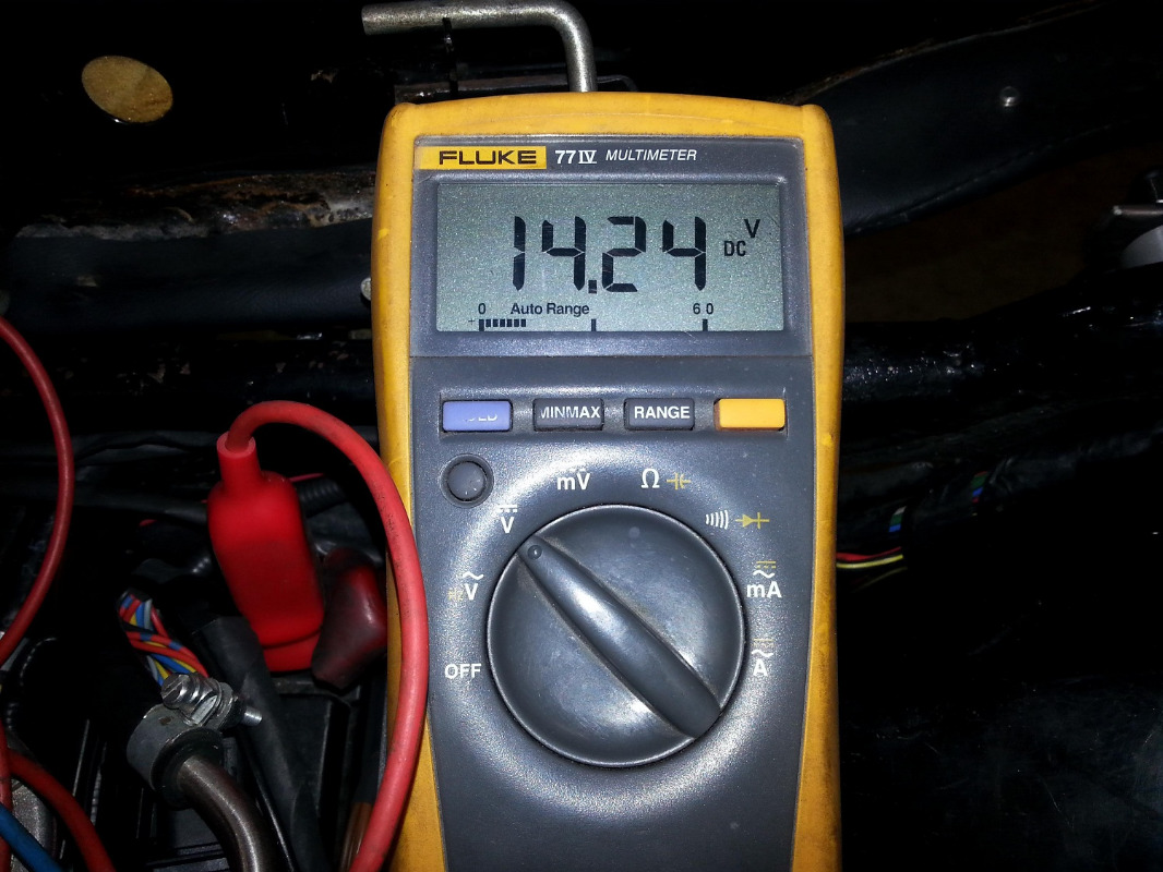

Here the awaited effect
14.2 Volt rpm just above idle, light on, if I'm not mistaking, and the battery was “just normally charged” like when you ride the bike for a week or two, starting going stopping, next day again... etc.

Resistance of two sections (from yellow cable --to the centre-- again to yellow cable) is 0.7 ohm.
