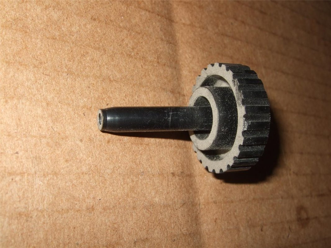

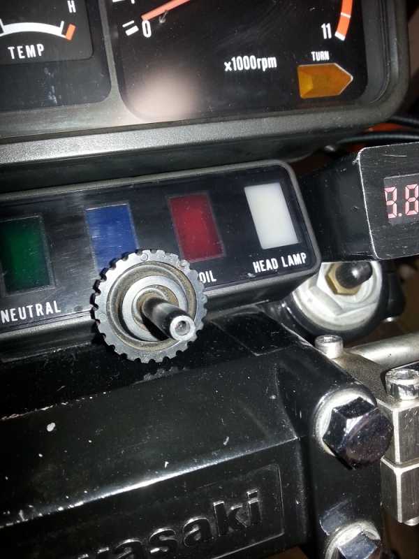

Looks like no metal insert in the knob on mine. There are threads on the metal shaft of the reset part though.

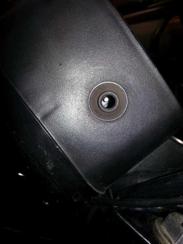

Thanks Daro, very helpful - just one more question - does the centre hole on the outside of the knob go all the way through to the threaded part? Just wonder if I can spray something in there to help loosen up the threads?
