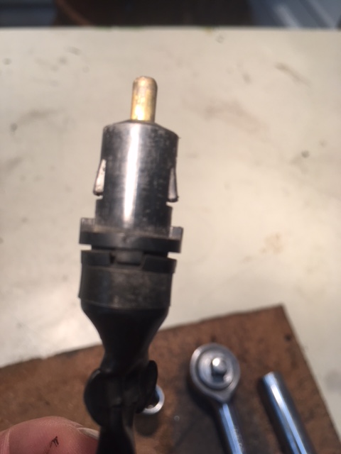

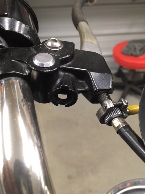

The Clutch-lever switch should look similar to:
The OEM clutch-handle perch:
When the clutch-handle is pulled in the switch closes to complete a circuit. I removed the clutch-switch years ago. Found it to be a P.I.T.A. when trying to start and wanting to adjust the choke lever at the same time. Easy to bypass - (sounds like a P.O. has already done this, somehow) Can't remember where the bullet-plugs are - Headlight bucket or under the tank ? . If you want to eliminate this switch just find the two bullet connectors and jump the Harness leads with a short pig-tail that has two Female bullet connectors. Now your left hand is free to adjust the choke , hold a beer or what ever !

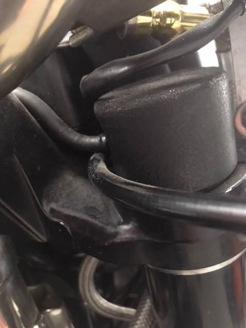

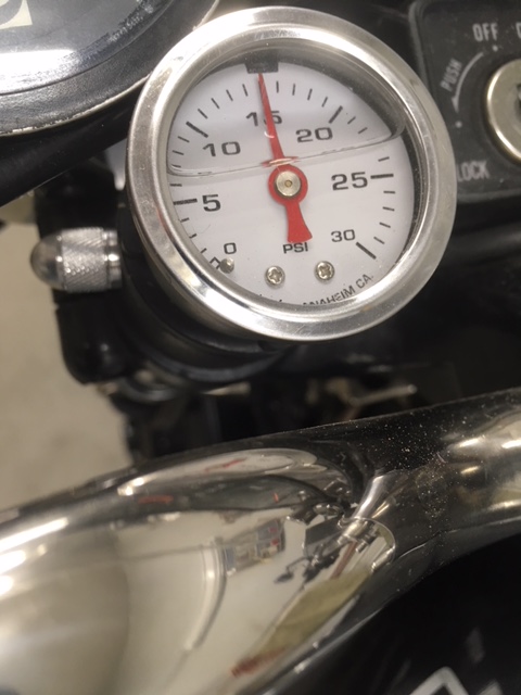

I need a close look at someone's bike to see the set up
I made my own from readily available off-the-shelf brass fittings. Covers (optional) were made from aluminum. Hope the pictures help.
