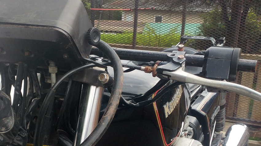

7 years 1 month ago #23958 by Tad
Replied by Tad on topic A5 refurb
Stan. any chance you can send me a close up of your clutch lever and the mounting. i am trying to establish bits which have been changed on mine. what i have at present if not right.
Tad
More
7 years 1 month ago - 7 years 1 month ago #23959 by StanG
Replied by StanG on topic A5 refurb
From my old photo - is this enough? I can take one after rebuild when back home in the evening.
