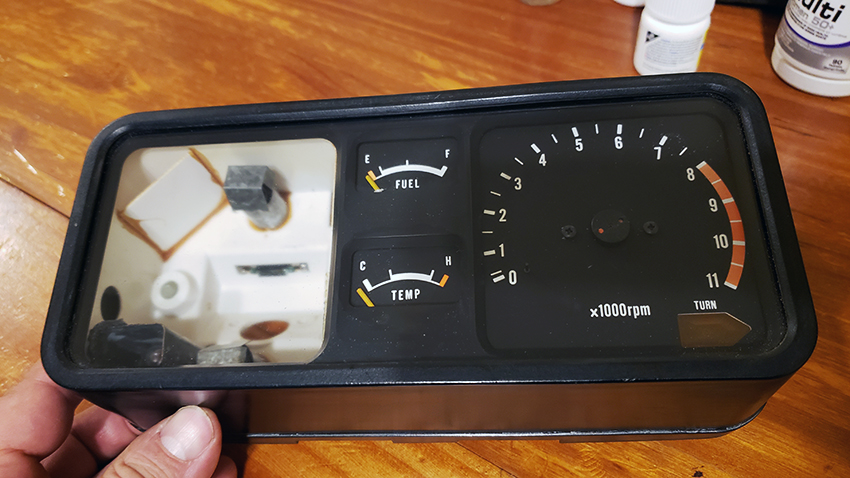

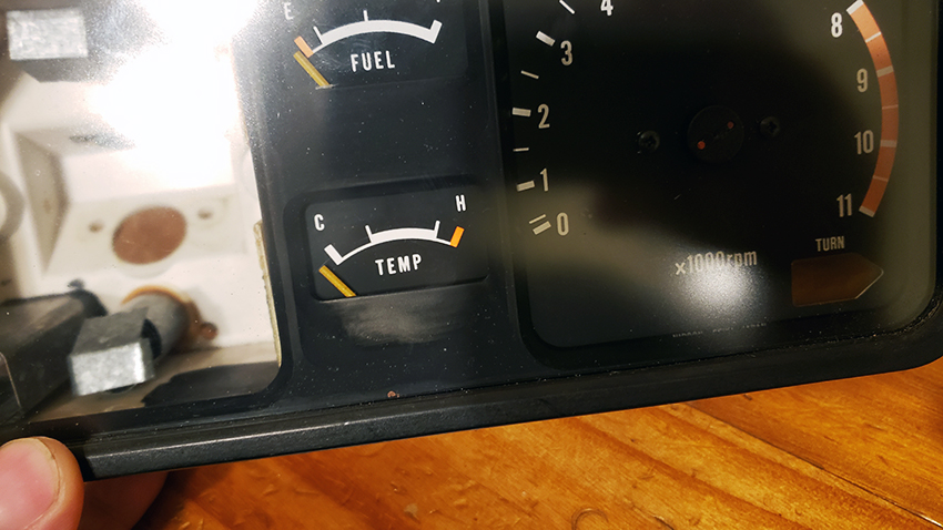

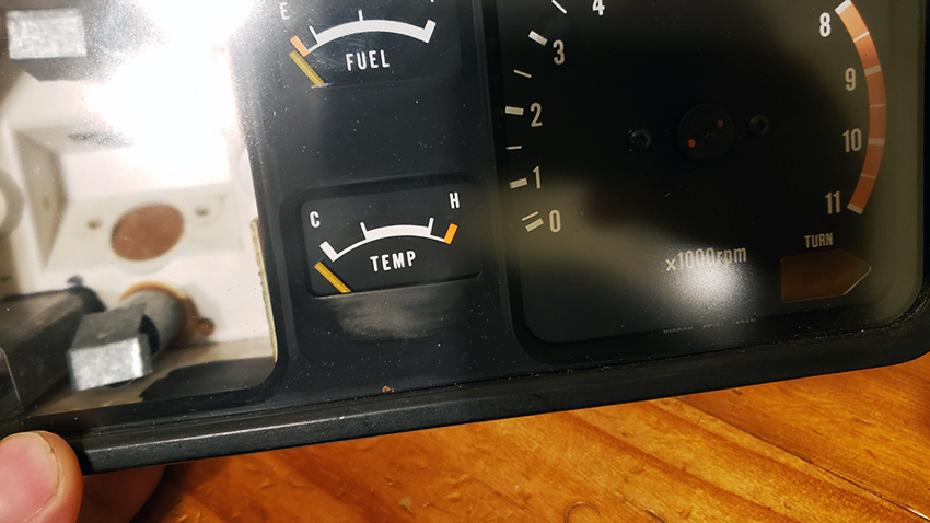

6 years 7 months ago #25289
by StanG
Replied by StanG on topic Removing the speedo assembly
To confirm, I got these from LareNurminen.
Scotch, yeah, by intuition I avoided even touching the faces at all costs! I made a stand cutting the bottom of a yoghurt container, at the right height, and keeping the gauge securely sit in it. To keep the dial fro, rotating while the needle cured overnight - I jammed a folded piece of paper under the center disk.
The coating - I am sure the type of medium used was specifically designed to keep any glare from happening. Like in slick gloss versus matte porous surface. Like what you see inside reflex cameras - it's matte and porous to eliminate light reflection. The stock dial surface resembles that finish. But actually that's not what I had in mind when asking, knowing dial replacements are out there to buy. (do they offer a similar finish or just mimic the look? - I have no idea)
My concern is the surface which is directly under the 'glass'. I thought it's just black plastic. Apparently not! There was a little spot between the face and the glass and I wanted to wipe it off with a cloth. That seems to wipe the surface of the face and disturb what to me seems like a special coating I mentioned. Now to the photos...
Looks great but.. under viewed from different angle not so. I will not care at all if this will not be noticable when mounted on the bike. Still, curious about ways of correcting this. I thought about squaring off the affected area to make it look uniform and consistent. But first - need to take care of the needle on the tach meter.
