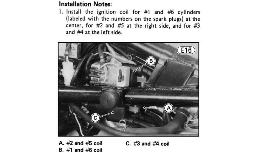

My bike is 1982 Kawasaki KZ 1300 A -4 .
I have been chugging away starting at the rear working to the front and in the process of removing ( interrupted several times) lost the plot which leads came off which plug and which coil outlet.
Two of the AW82-TRI coils are cracked pretty badly so will replace them . Will probably go for an aftermarket which has taken hours to read and research!
The following is the plug to coil layout that I think: BUT really need it confirmed.
Could I have advice on the correct "spark plug to coil " order. The firing order is 1 -5 -3 -6 -2- 4
Looking to the front of the bike;
Top coil RHS HT lead to cyl. 6
LHS HT lead to cyl 1
Left under coil. RHS HT lead to cyl 5
LHS HT lead to cyl 2
Right under coil RHS HT lead to cyl 4
LHS HT lead to cyl 3
Thanks
Bill
