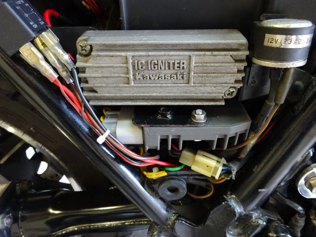

Agree with Kawboy that a series regulator is the way to go. Looks after the stator and reduces heat to oil. The SH847 is a monster and will not fit in the same space as the original OEM regulator. I bought a genuine Shindengen SH775 series regulator (search ebay for "NEW SH775 voltage regulator rectifier Polaris Ace Ranger RZR EP4T ETX 4012941") but beware of fakes! This is rated more appropriately for the relatively low alternator power of the early Z1300's. With a bit of simple metalwork, it will also fit in the same space as the original.
