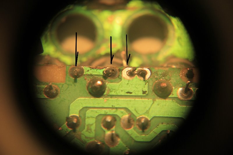

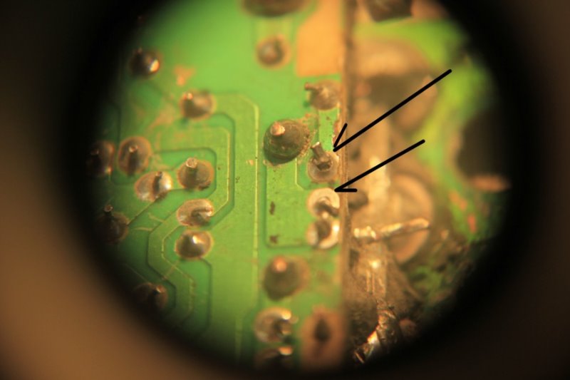

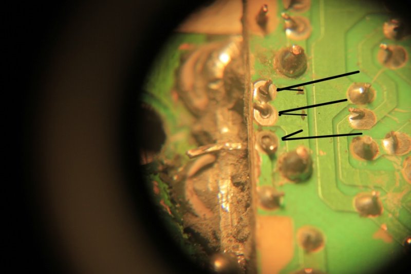

Hi Greg.
Can't speak from experience regarding the Igniter but can with respect to the Voltage Regulator and the Auto Turn Signal cancel unit. The problems I had with these and many other non motorcycle electric components are, I believe, similar.
All suffered from bad solder connections ! The higher the voltage/current, the more obvious the fault. Unfortunately this can't be predicted. In my cases of the V'R and signal unit, I had to dig-out the potting material from around each of the wires to find the one causing the problem. The most obvious was with the V/R. I hypothesized the high current and bad soldering connection started to create arching which on several yellow inputs had vaporized the solder. The damage was obvious ! With the signal cancel unit; Needed some magnification to see the solder fault.
Some of these OEM components are readily available so it's possible to replace them - if you're wiling to take a chance on something used.
Personally, I have no problem attempting these types of repairs. The "work" is in accessing the connection. The re-soldering takes seconds!
This doesn't omit the chance that, for an Igniter, a component hasn't failed. That's another thread !
Hope this gives you something to consider.
The pictures are from a thread I did. This is my OEM V/R. I replaced it with a MOSPHET unit.
