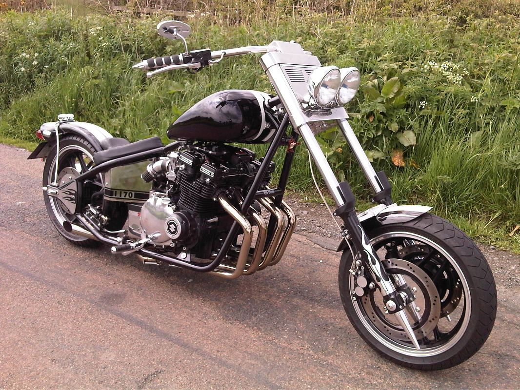

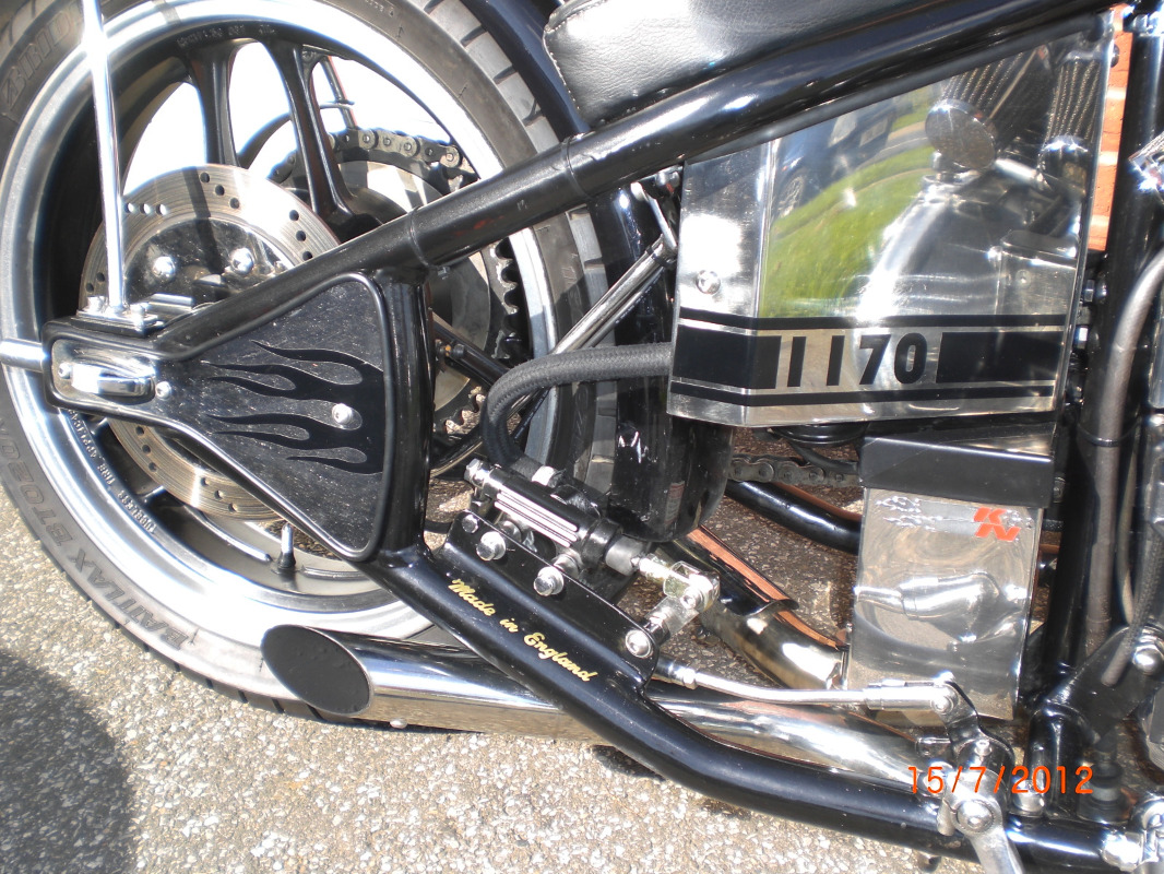

I had a similar challenge with a Chop I built 8 years ago as like you only had limited space for the battery and elec components.
You can see what I did in the first photo below (with the K&N Sticker on it) and it worked well.
Your 1300 Ignition CDI Unit never gets hot, despite having what look to be cooling fins on them.
Fuse box should remain cool unless it has an issue and the only part which can get slightly warm under exreme conditions is your Voltage Regulator which also has cooling fins on it too.
I personally would cut some sort of "inlet" airflow hole at the base of the box and an "outlet" at the top just to allow a small flow through, but silicon some mesh inside each hole to prevent bugs and critters getting in an making it home !

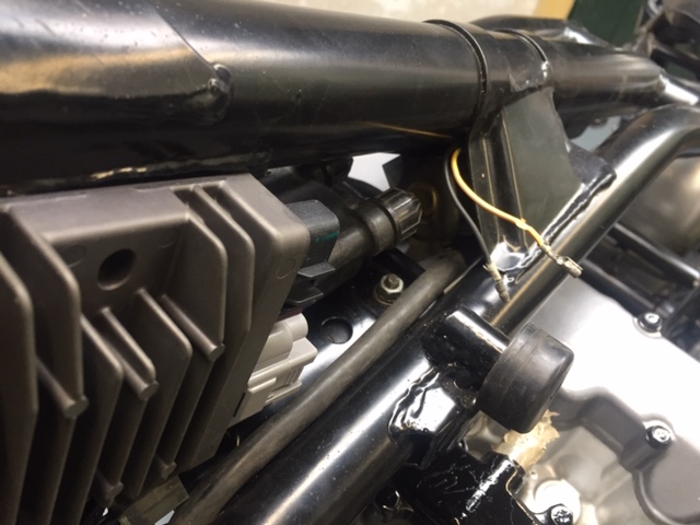

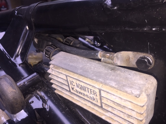

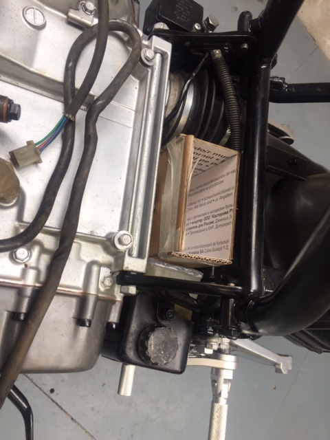

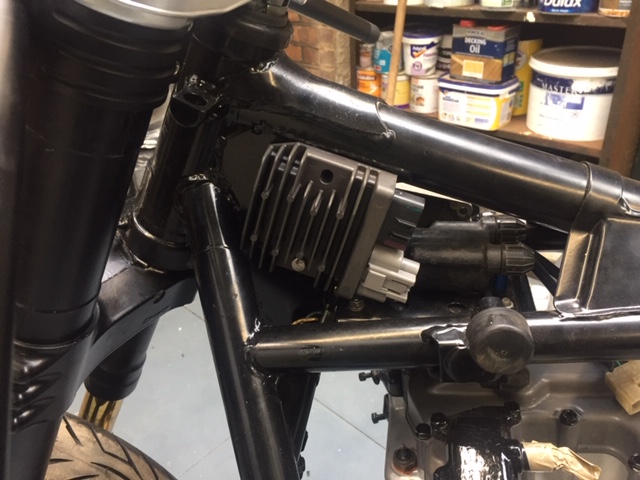

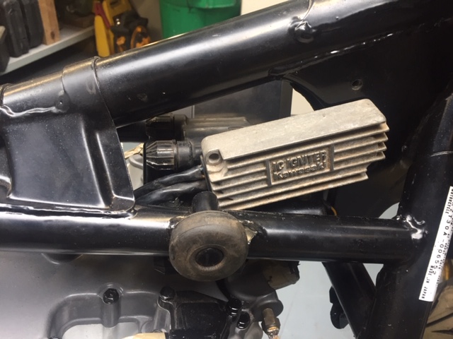

I did a mock up with a box made from cardboard and it simply doesn't all fit in.
So I found another place...
They should keep cool there as they are 'in the wind' that goes underneath the tank.
And if you look carefully you can see the ignition solenoid tucked below the wide 'bridge' with the starter cable connected and the earth connected just above the Igniter.
That means that only the battery and the digital fusebox need to go into the box behind the engine block - and they fit no probem.
