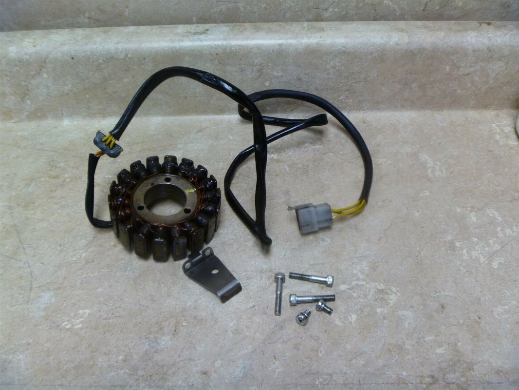

Sometimes a pic is worth a thousand words. This pic of an aux (left side stator) came from an ad on EBay and judging by the length of the lead coming from the stator, I'd say the stator plugs directly in to the aux regulator/rectifier.
Hope this helps.

Kawboy wrote: Sometimes a pic is worth a thousand words. This pic of an aux (left side stator) came from an ad on EBay and judging by the length of the lead coming from the stator, I'd say the stator plugs directly in to the aux regulator/rectifier.
Hope this helps.
KB
I can confirm that, when rebuilding mine the yellow three wires went straight into the regulator. This was the instruction on my new Shindengen.
