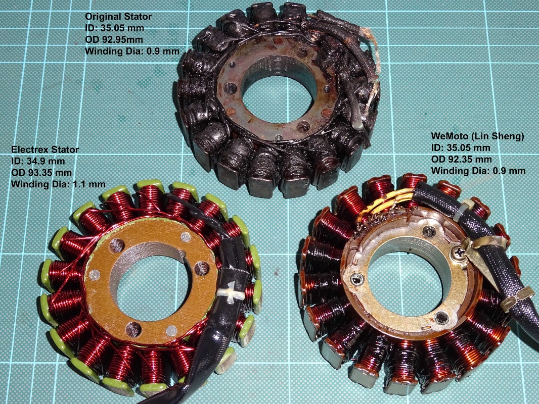

5 years 8 months agoNeville wrote: My solution has been to fit the best quality stator I could find and replace the shunt unit with a Shindengen series type regulator (SH775) - see www.kz1300.com/index.php/forum/welcome-n...r-with-1979-z1300-a1 - page 4.

I was quoting someone else but I have found these to be excellent quality. However, it will still suffer from the poor design of the original shunt reg/rect and 3 pin connector.
www.electrexworld.co.uk/index.html

Curious which one you had the best luck with.
The best I have found so far is the Electrex - with the fly leads connected to the windings in the same way as the original fit unit. I've had 3 failed Lin Sheng units - the stator temperature was high enough to melt the solder connecting the fly leads to the connector terminals.
