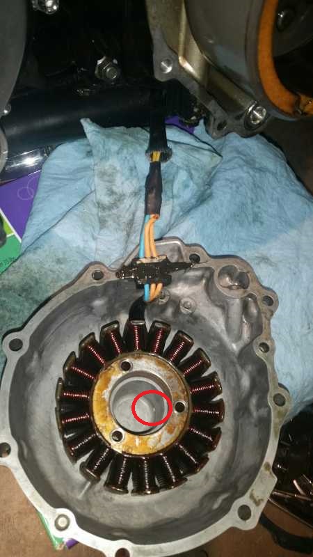

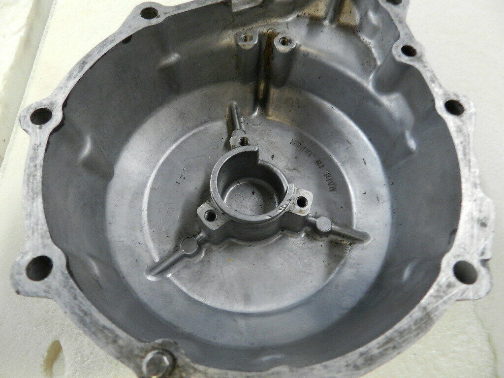

It's my understanding that the '80B's and up had the alt. cover cast to supply an oil-spray to cool the stator. The '79 and '80A's did not have this oil spray feature. That's not to say there's no oil in the'79/ '80A covers. There is....and a lot more then one might suspect. The oil comes from the crankshaft end bearing. This oil is returned to the oil-pan through a port in the crankcase, adjacent to the bottom of the cover. I will further surmise that Kaw. made an effort (?) to cool the non-sprayed stators by utilizing air circulation within the cover. It was likely Kawasaki's assumption that the oil being discharged out of the end bearing plus some air movement would be adequate to cool the Stator. Clearly it's not. The subsequent change to an actual oil-jet spray substantiates this.
Note the two covers. '79/80A vs. the later oil-spray version.
The oil nozzle in the later versions can be seen in the inside of the stator pedestal. Note on the '79/80A, the "notch" in the pedestal. The "notch" is not present on the oil-spray version. I believe that this notch was intended to provide a path for air flow into the center of the stator where the spinning rotor centrifugally discharges this air within the cover. The rotor acts as a rudimentary squirrel cage fan. How much oil is scavenged and distributed along with this air is unknown but clearly not adequate to sufficiently cool the windings. The problem with this design is there is no replacement/supplemental air to aid in cooling. The air within the cover just gets hotter and hotter and eventually the insulative coating on the windings fails from heat break-down and that's the end of the stator.

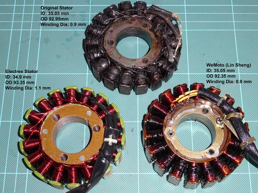

This seems to be a very common problem, particularly for early models. From my experience (5 stators and 3 regulators), the key issues are:
1) Not all stators are equal - the original fit unit was a much higher quality part - the replacements are less robust - see www.kz1300.com/index.php/forum/electrica...ll-stators-are-equal
2) No organised cooling - later models incorporated a cooling channel to direct pumped oil onto the stator
3) The "shunt" type regulator originally fitted ensures that the stator produces its maximum current v's speed at all times - even when not needed. A "series" type regulator ensures that stator current (which heats the stator) only meets demand and no more.
My solution has been to fit the best quality stator I could find and replace the shunt unit with a Shindengen series type regulator (SH775) - see www.kz1300.com/index.php/forum/welcome-n...r-with-1979-z1300-a1 - page 4.
