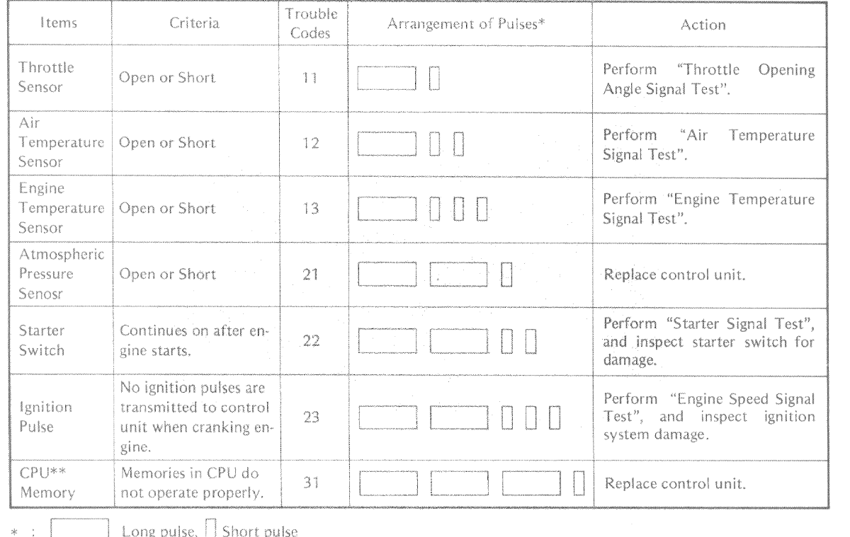

As far as your DFI code as per the chart I got from the Zn1300 Manual what the DFI is telling you is that there is no pulse signal coming from the engine and of course there's not. The engine is not turning over so don't worry about that at the moment.
