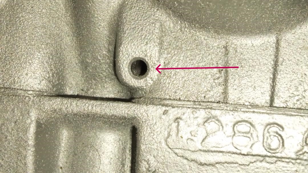

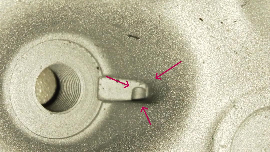

In this photo you can see the drain hole next to the spark plug thread.
They are located on cylinders 2-3-4-5.
Here you have one of the outlet holes, below the intake manifold and above the head gasket.
