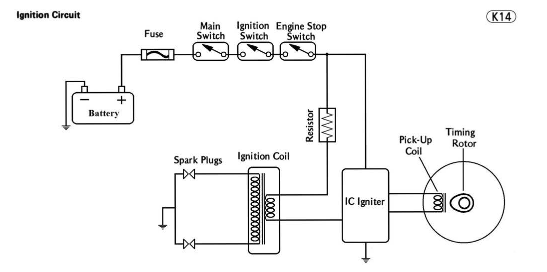

You didn't set up your test circuit properly for a wasted spark coil. From page 237 of the Service Manual
There's a reason the bases of the spark plugs are joined together and only by coincidence are they tied to ground because the cylinder head is grounded through the engine ground.

The spark plugs should be connected to each other, not to ground (I realize you have them connected together at the negative terminal but that's not required). As Kawboy mentioned, the bike ground (the head in this case), is 'floating' with regard to the coil outputs. Similarly, the cores of the OEM coils do not need to be grounded in order for them to work (I only mention it as I often read online advice telling people to ensure there's a ground wire to the coil core which is not required for this type of ignition coil (or rather, not required for the OME ignition coils).
