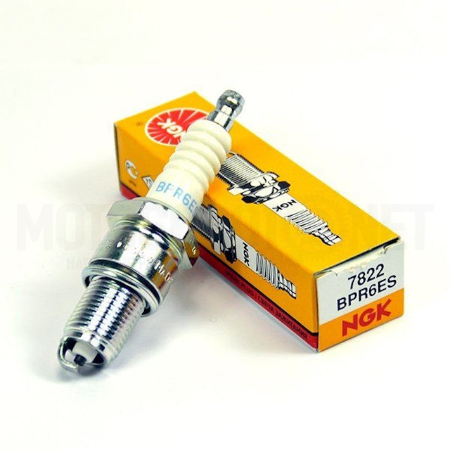

I believe the standard plug should be BPR6ES. I run the iridiums in mine though

A BPR6ES spark plug if it is of a good brand can cost between 6 and 8 euros.Much less if it is of Chinese manufacture.

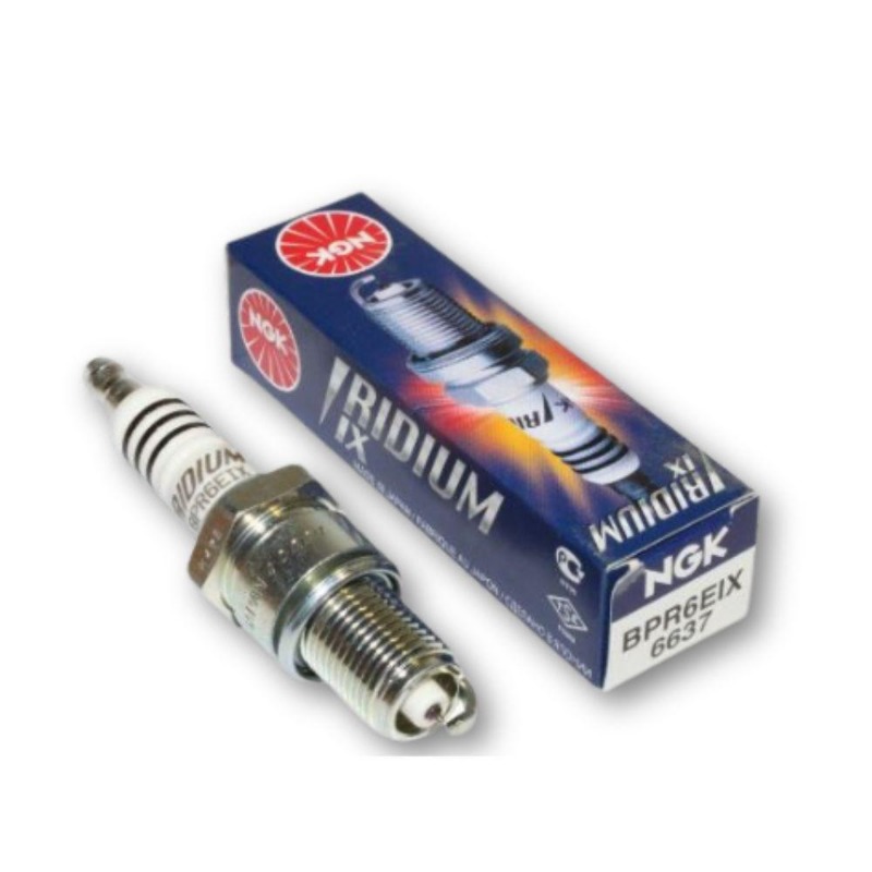

If you decide to install an Iridium spark plug, much more durable and efficient, BPR6EIX.Its cost is between 18 and 25 euros.

I have gone the Iridium route, £16 a piece. BPR6EIX.
I once again bought some new cheap plugs, before I realised that they may be the source of the problem. They can now go to landfill !!
