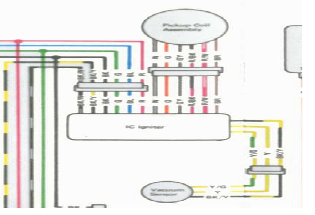

Hi I’m re wiring my 83 z1300 and I’m stuck from the pick ups I have orange/red/brown/white/pink and grey but from the ignition box I only have red /orange/brown and grey
I can’t find any wiring diagram that matches these thanks in advance Mike

Welcome to the site.
If you don't have the Service manual for the ZN1300 it's available to members as a download. You need to open the main "Forum" tab and scroll down to the bottom of that page. You'll find all the manuals available there.
From page 35 of the ZN1300 Service Manual, the 6 wires plug into a 6 pin connector which is wired to the Igniter.
This is a cut and paste from the upper right hand corner of the main wiring diagram.
