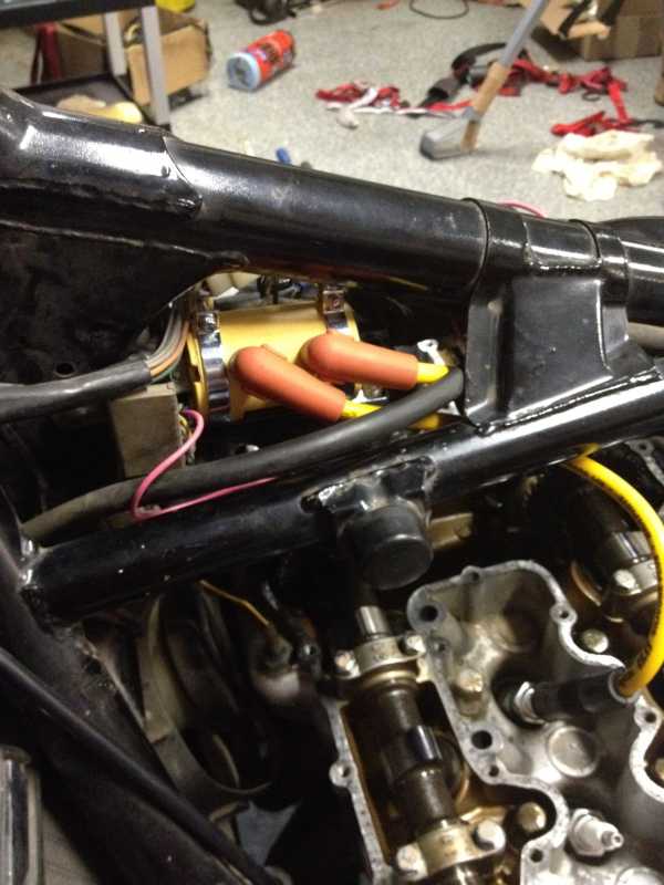

I'm in the process of trying to figure out a good way to mount these. In the instructions they mention having the towers pointed down. Is that really necessary? Seems as though it shouldn't matter which direction they're facing. Much easier to mount with the towers facing to the side and not have to cut a hole in the stock mounting plate under the tank.

Go to my post about new Accel coils I just put a set on and I have picture in that post how I did it. Your going to run into two problems. The first one being you can't put them in the same place the factory ones was with out putting two coils on top and one under. In other words back wards of the factory set up. Why is because the coils are bigger and it will not clear the coolant inlet. The second problem is to get clearance for the towers you have to cut the center of the plate out and you have to use longer bolts and spacers to space the coils apart so you can get the plug boots on. Now I will tell you this its not that hard take your time and boy does it make a big diffrence.

Yes I saw your Post and it's the one I'll probably use but as I was fiddling around with things I determined that with one above the frame rails in the center and two below they can be made to fit quite easily using and modifying slightly the mounting plates that come with the Accel kit. Only issue would be the towers need to point sideways instead of down as they recommend. Was just curious as to whether that would be any issue. Why do they insist the towers be pointed down is my question?? Seems to me they should fire fine whichever direction they're pointing. By the way, thanks for your post, I hadn't thought of cutting the center portion out. Here's how I mounted the top one. The other two will fit under the frame rails in the outer mounting holes BUT the towers must point sideways.

pointing down with the tower is so that if you every burn thru the plug boot your not throwing your spark into the side of the fuel tank. The paper work that came with my set said not to point towers toward fuel tank. Like I said in my post I gapped my plug at .40 not .35 . these coils will throw spark across a .60 gap with no problem.
