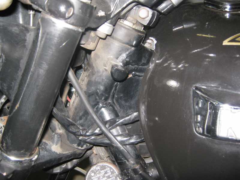

Hello all,
I am now about half way through the resto of my A4. Just put the engine back in, now starting to look like a bike again.
Went to put the main wiring loom back in and hit upon a snag, of all the photos I have taken I overlooked to take one of where the loom is routed around the head stock area :oops: I have looked in my manual but there is no clear photo of where it goes. Is there someone out there who is able to take a photo for me and upload it so I can get it right.
Thanks in advance.

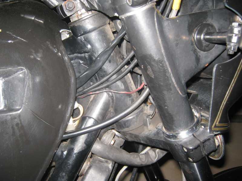

Re: Main Wiring Loom
11 years 9 months agoIgnore the black painted red wire, I have a broken power wire in the harness and just ran a power wire to the headlight bucket to bypass it

Awesome thank you.
