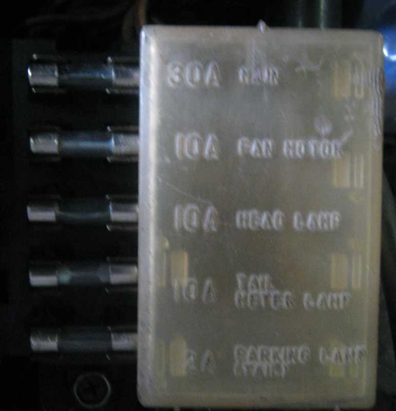

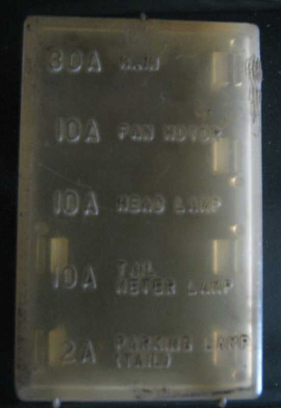

After a bit of shopping today, I discovered that all of my local businesses no longer carry the size of glass fuses that my 1980 KZ1300 A2 takes. A standard size glass fuse will fit, but it's about 5mm (ish) too long. In addition, I'm missing the cover to my fuse box, so I have no clue where each amperage of fuse is supposed to go. The owner's manual is no help, and my service manual only has a wiring diagram (with the fuses in the wrong order). So, my questions:
-What physical size of fuse should I be looking for? Is there a type number I can search for?
-What order are the fuses placed in the fuse box? I know the main fuse is on the top (right side of the bike), but after that I'm lost.
Thanks in advance!
Thanks in advance!

From the Right side to the left side: 30A Main, 10A Fan, 10A Headlight, 10A tail light, 2A Park lights. The correct length can be bought on Ebay. I had no luck finding an automotive supplier that carried the shorter size.

Definitely have to get me one of those.....
Good luck with THAT happening. Will probably end up making something instead...
