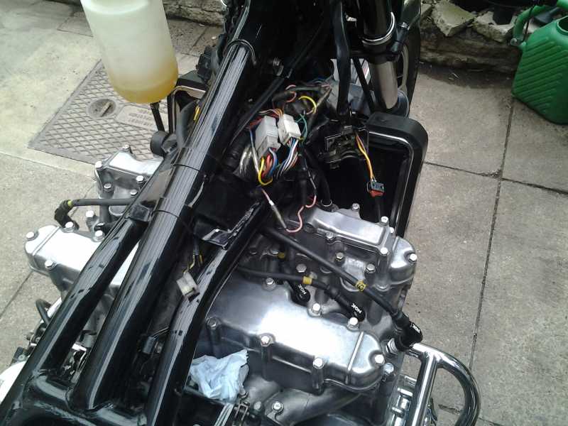

Just spent yet another day trying to locate no spark? Though did have a low spark on all six and tried to fire up? Then no spark at all
So took off IC unit and checked all resistance's as per workshop manual. On all female connector pins all readings ok, but on the male 6 pin connector lacking readings. Which shows that transistors gone belly up? Unable to understand why blown. As bike running great and only left for a week to find no spark. Could faulty coils have caused the problem. Have got the new coils to fit as yet, but any info why the transistors have blown would be helpful as would not be a happy bunny if order a new IC unit and the same happens again.
