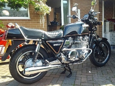

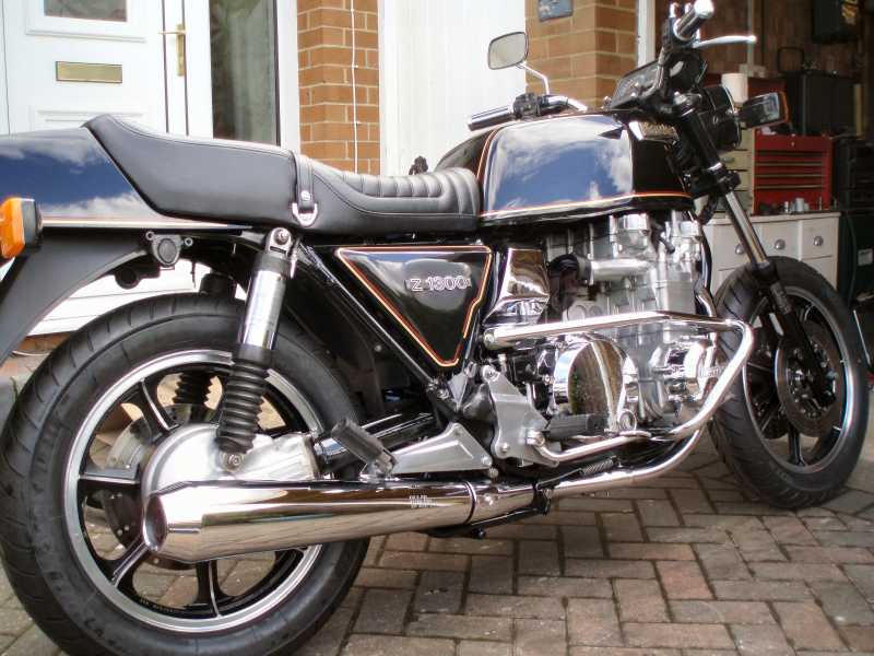

Hoping you find the problem, but I just wish to say that your bike looks fantastic. Can you tell us what work you have done, especially regarding the paint and chrome?

Re the bike, chrome and paint work. Paint work took months to sort. Got in touch with so called sprayers who promise the earth and never deliver and one guy buggerd the tank up big time. So took the aproach. If you want a job done right do it yourself. So done the front fender as a test case and turned out fine. The tank was a differet story and i buggerd it up more :whistle:
So through a contact. The guy who does all my seat recovering on projects gave me a number to ring. A top sprayer who is into bikes so the perfect job was done and even sprayed the decals in.
Re chrome work. In the right place at the right time. Picked up a brand new exh system. Down pipes, collector boxes and a right hand new muffler + a new seat unit for £800. Crank case covers could do with rechromeing but are in good condition for the age of the old girl.
Still need the odd part to bring back to former glory. Such as a pair of handle bar grips? Any members got any :ohmy: Purchased many a part from Zpower and the guy in Germany who is very good.
Safe and happy riding to you all. And keep the info coming re no spark as testing out some of the forum solutions to solve the problem.
