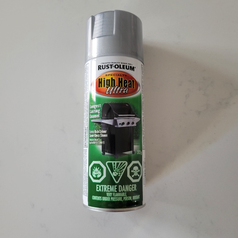

Next was to look into "alternative paints" such as brake caliper paint and last but not least, BBQ paint. All of the brake caliper paint I was able to check met the heat requirement and no primer required but still needed to be heat cured at 200F. Finally, I came across "Rust-oleum High Heat Ultra paint" Good to 1200 deg F no primer required, no heat curing, satin finish bright silver and if the cap color is any indication, it looks like it has micro aluminum flakes in it. This could be interesting, so I bought a can and I'm going to give it a try. $28.95 CDN a can. What the Hell happened to the price of things lately?? Rattle cans used to be $7.95. God help us !!

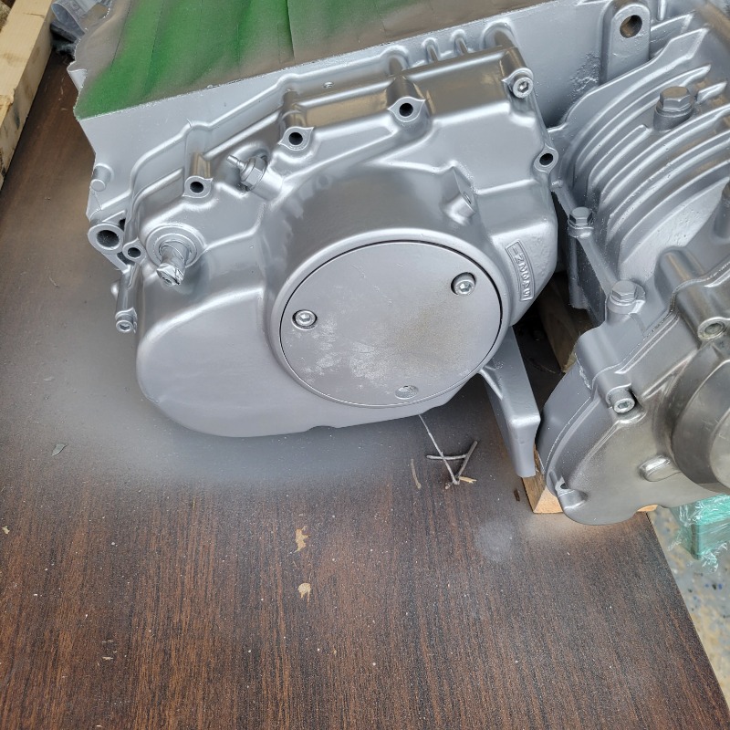

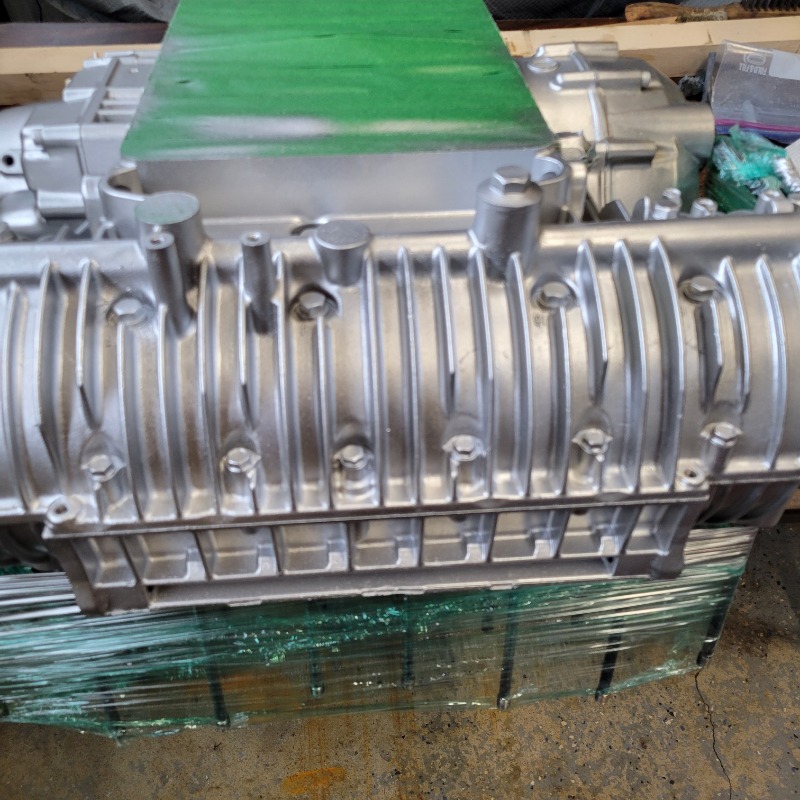

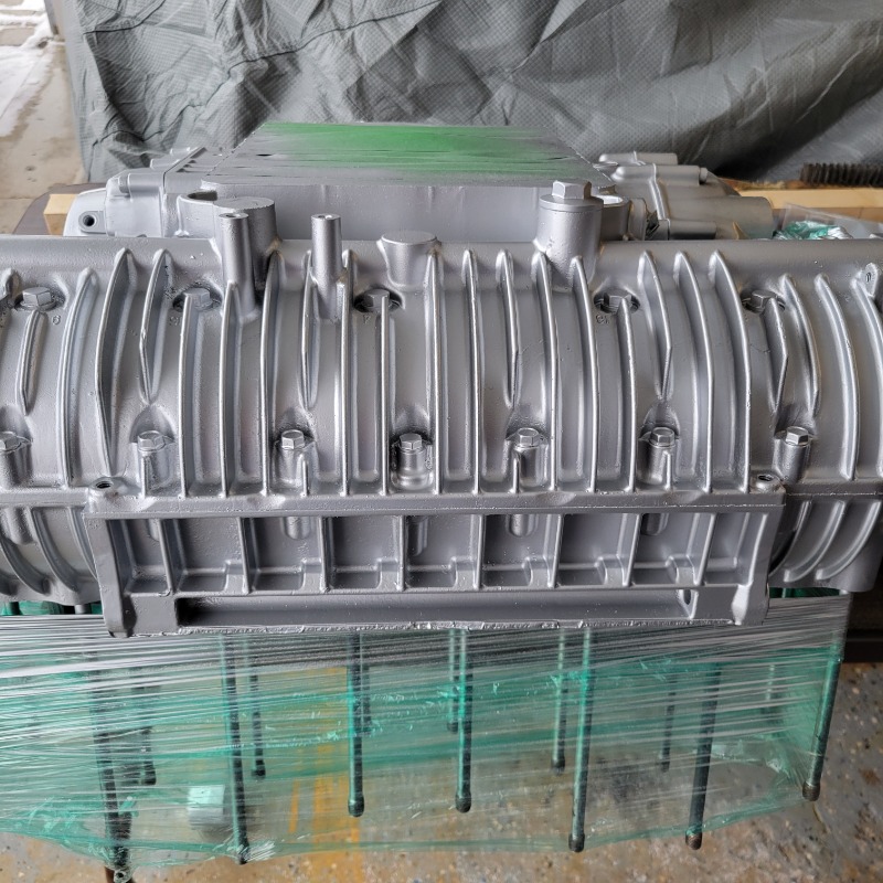

Got a chance to finally spray the Rust-oleum BBQ paint which is a satin finish and has a bright aluminum micro metallic in the paint. I started on the bottom of the engine and sprayed most of the bottom. Once it dried, I decided that I don't like it. It's too bright, so back to the drawing board.

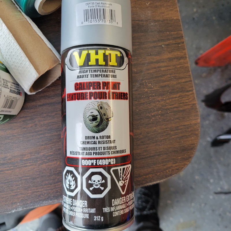

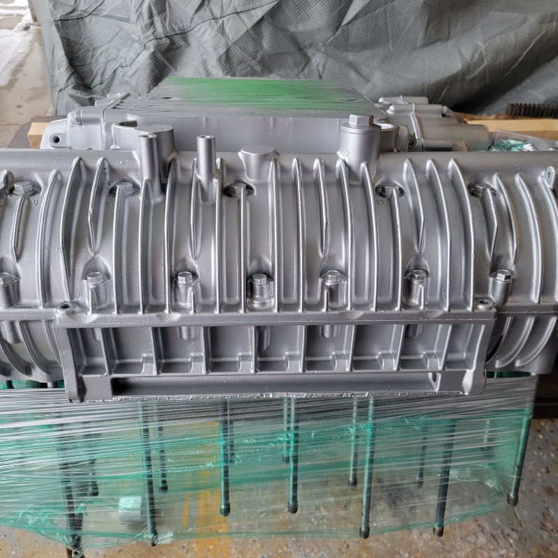

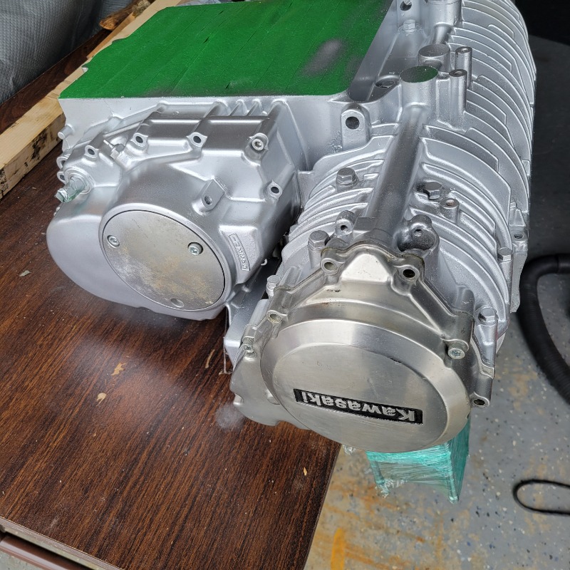

Next up, VHT Brake Caliper paint in the color "Cast Aluminum" This one needs to be bake cured at 200 F for 1 hour after the paint dries and the instructions suggest that the heat of the brake caliper when in use can achieve that. So I sprayed the bottom half of the engine again and I like it much better. It has a satin finish and no metallic. Slightly more to the gray side than the aluminum side.
Rust-oleum BBQ paint. Too bright for me.
