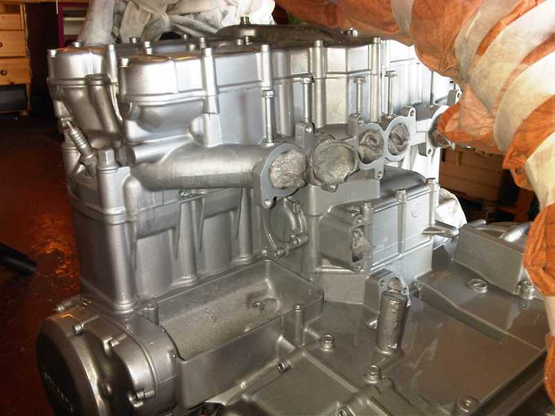

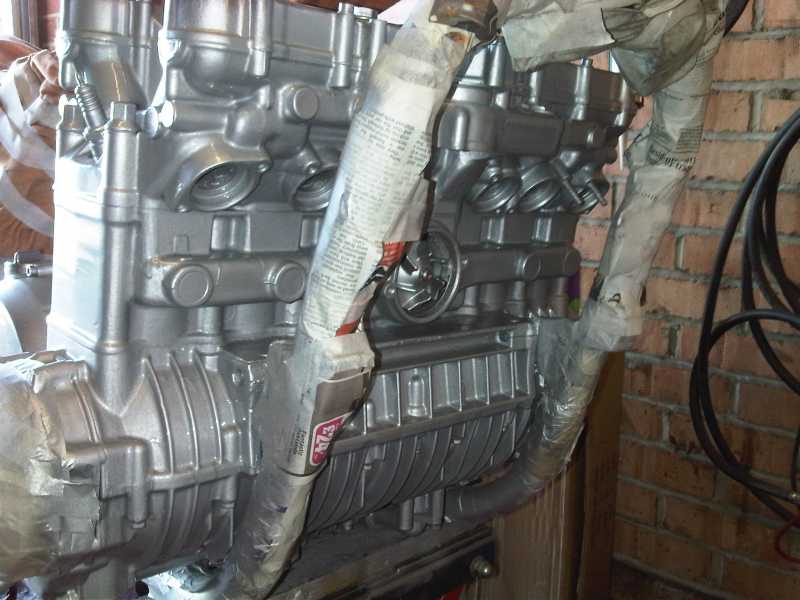

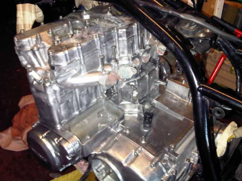

If you look at the FIRST photo in my post above, you will see how clean I get the engine before painting......Its basically very clean bare metal. Lots of work with a snake neck flexi in a drill with a small wire brush & a pointy screw driver to get to the difficult bits. It takes a long time but is well worth it........see below.
Its REALLY good !
