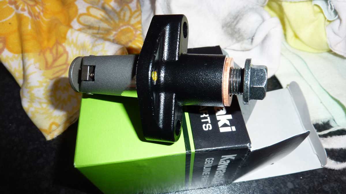

Re: Camshaft Chain(s) - Options?? part# 92057-1018
10 years 10 months ago
Oops ZX-10 is a typo, meant to say zx-11, also used on the zrx-1200 and the Concurs. Kawi part number is 12048-1113.
This is the part I used.
I Removed 10mm in length from the spring. There are a number of people on this forum and others that have run this part for many thousands of miles and inspected the tensioner parts and guides afterwards. It is the best option for the 1300 IMO.
There is an option to replace the plastic sprocket with a metal one, I have no experience with that part. I did however replace the plastic and rubber rollers on my KZ650 with metal sprockets made by Liska as well as a manual tensioner. Keep in mind the 650 uses a roller chain. While this may be a more robust set-up it does increase the chain noise.
