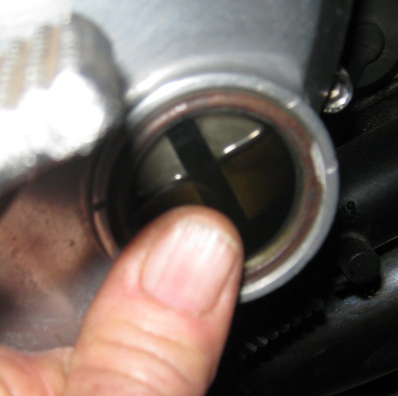

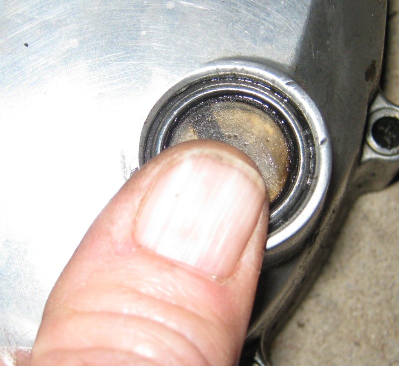

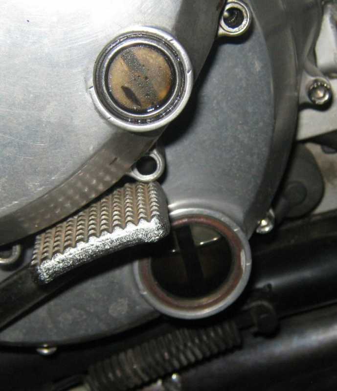

Hi I have an early Kz 1300 frame number 874 engine 911 & stamped on clutch cover is 4.6ltr, small sump, I have just done oil & filter change but not sure which sight glass I have hard to tell from pics, my sight glass is 19mm across the glass itself. Well I ran the engine stopped it and then checked after 10 minutes correct for high oil mark but over night settling it is aprox 2mm higher than high oil marker, the height check is at the lower part of the oil where it dishes in the middle, I did put in more than the 4.6 ltr think it worked out at 5ltr, then I was told if too much oil it is not good as will froth where the pick ups for the cranks dip in the oil? Is this correct or is this just at initial start up? The oil is Motul 5000 ma 10/40w semi synthetic .
- Kawboy
- Posts: 3243
- Thanks: 1198
Re: Oil Level Viewing Glass Query
7 years 11 months ago
Yeah, you're a little high. I would be tempted to dump 200 ml. If you choose not to, I think you'd be ok with regards to frothing. On these bikes keeping the oil level up at the top is probably the best thing you could do. It actually helps keep the oil temp down a tad.
For the future oil changes, the galleries in the cylinder head are many and don't drain as nice as I would like them to. Try to put in the 4.6 L and let it sit for a loooooong while before topping up. As you have demonstrated, sitting overnight has increased the oil in the sump substantially. When running the engine, that extra oil will be hung up in the cylinder head for a while but when the oil is really hot, it will run down to the sump much faster than when just changed and warmed up.
