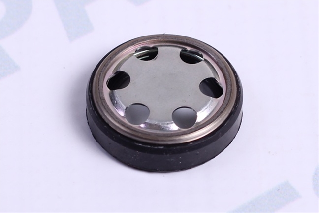

I would say it's pretty hard to screw up. The gauge is a glass window with a circular steel disc on the back side with 6 orifice holes in it to allow the oil to settle in the window. Pretty much idiot proof.
Here's a view of the back side.
