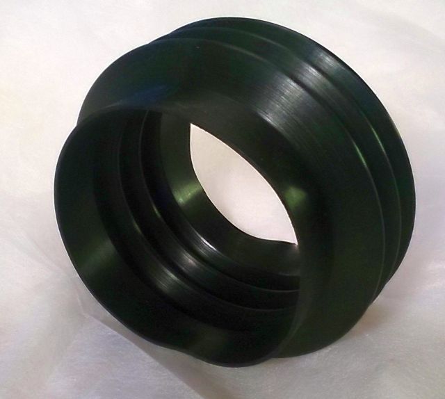

You could have bought yourself one made from Nitril Butyl Rubber which resists oils, road salt etc. We have them available at:
www.kawasaki1300parts.com
You will find other goodies there as well, made by Kawasaki 1300 riders and enthusiasts.
Brgs, Lauri
