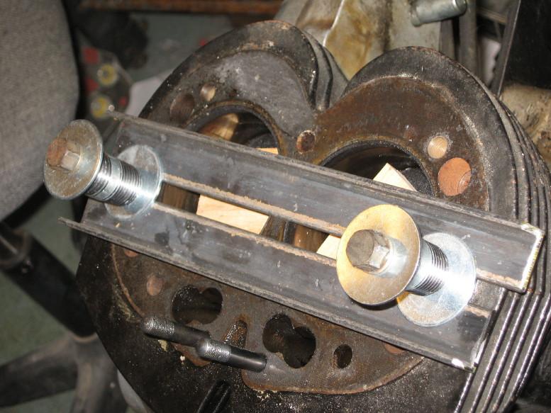

Cut two blocks of 3/4" wood to fit inside the cylinders, on top of the pistons. Bolt a bar across the cylinders with the head bolts. Then gently turn the crank so that the pistons push the blocks into the bar, and it will lift the cylinders right off?
