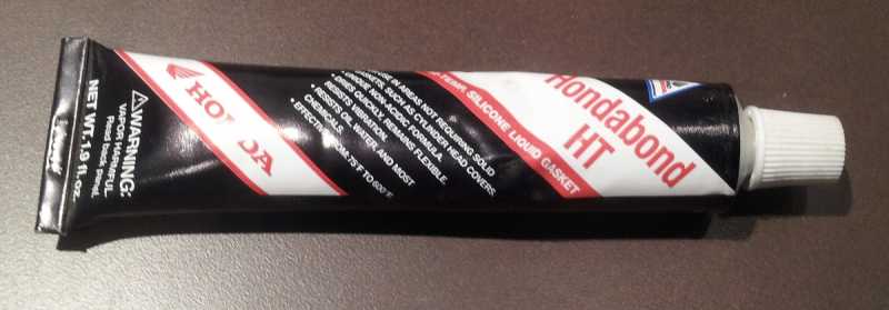

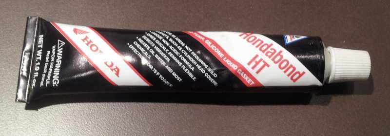

Hi Mike, The grommet you're struggling with is always tough to seal. As you've described getting the oil off of the old grommet and wiring is critical. I've been using Hondabond HT with great results even with an old failed grommet.
Hope this helps.
Bill
