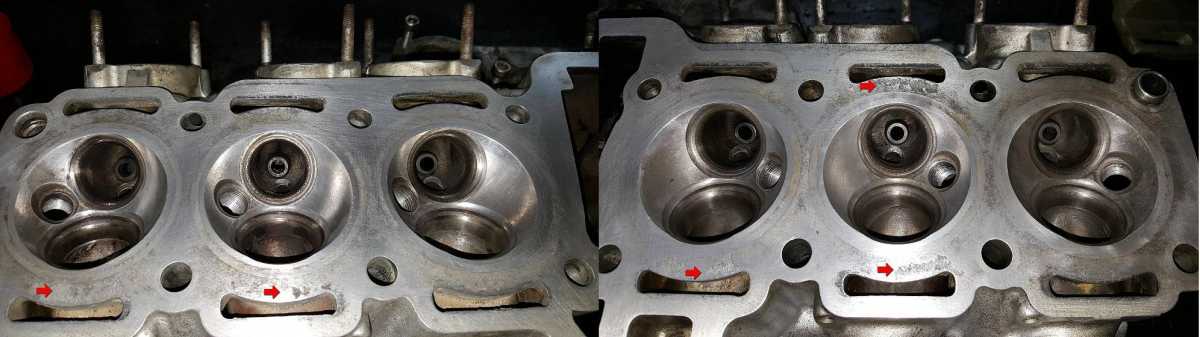

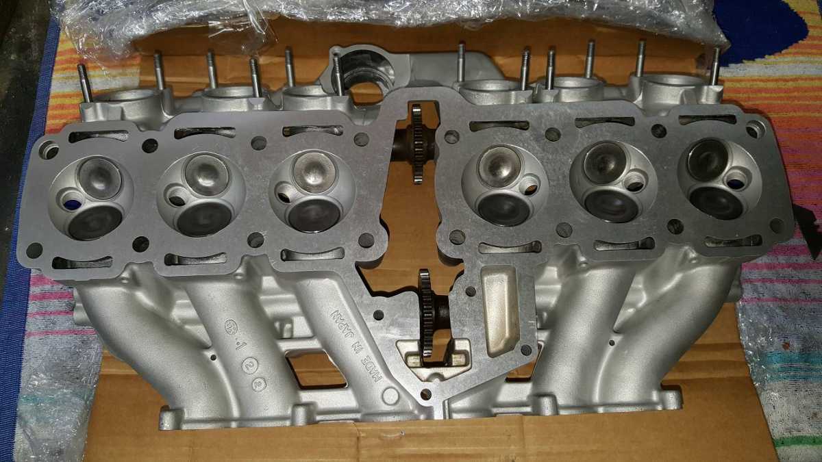

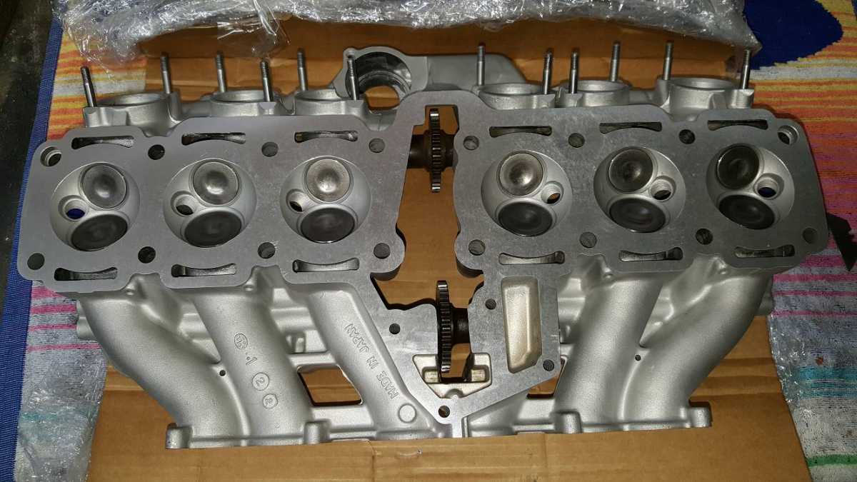

Anyway here are photos of the before and after of the head.
