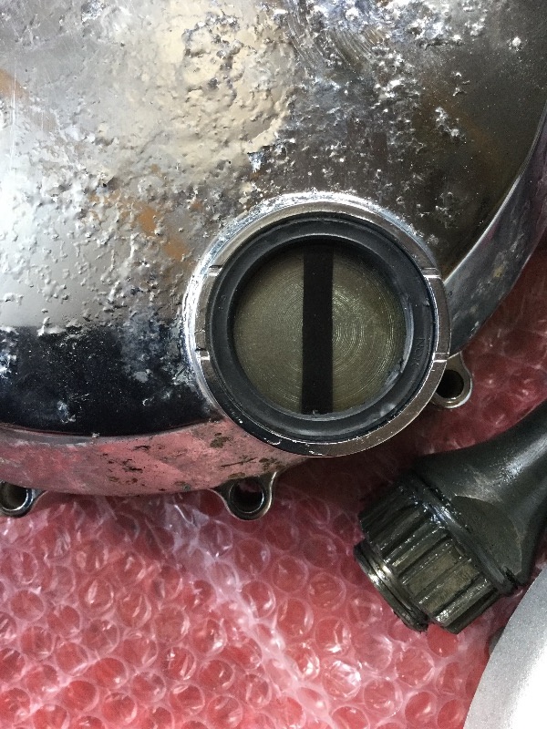

Hi Gents,
As I need to get the crankcase covers re-chromed I need to get the oil sight glass out. Can anyone tell me how it's done.
Regards
Martin

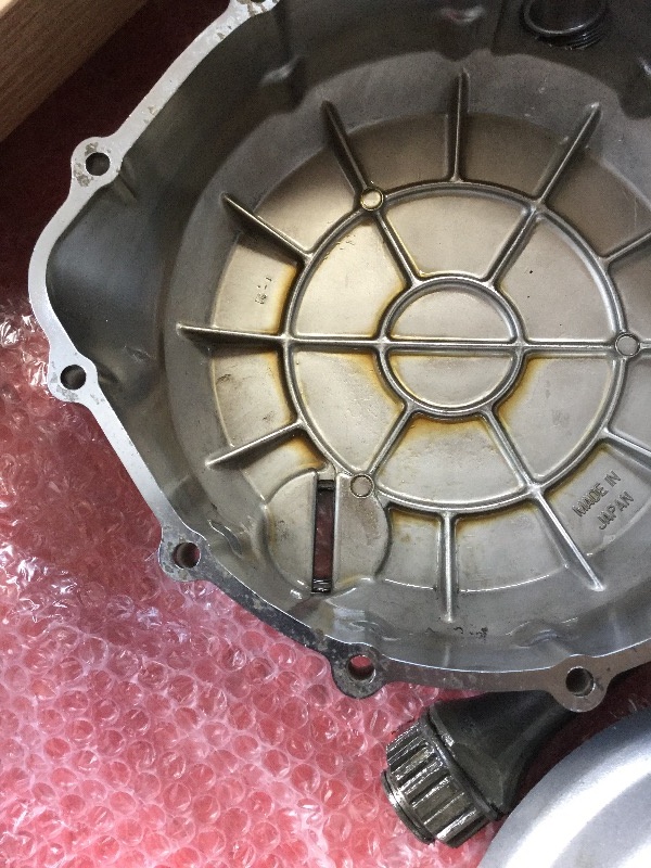

The picture is worth a thousand words. You're just going to have to push out the glass from the back side using a narrow screwdriver through the slot in the housing. It will just be a snug fit.Maybe a very light tap on the end of the screwdriver if necessary.

Thanks Kawboy,
I didn't think it was that simple. Thought there would be something else holding it in.
