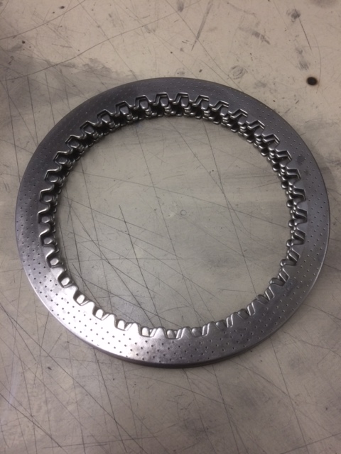

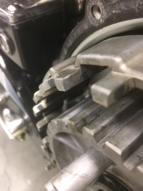

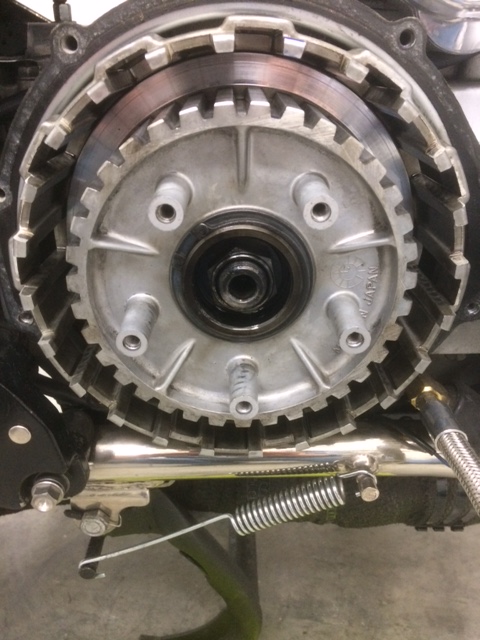

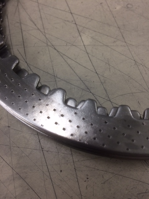

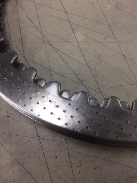

For those who have wondered what's behind "the Mirror". Changing out these plates is one of the easiest owner-doable projects there can be on this engine. Even if you're the type who needs three friends to turn the ladder while you hold the bulb ! The wear-faces of the steel-plates were covered in a golden-brown coating that at first glance looked like rust. Did not want to come off - even with Lacquer-thinner. A good cleaning on a wire wheel removed this with no detriment - these plates are hardened. The coating is obviously friction-plate material and I wonder if this is what causes the clutch to stick (not release) when the bike has sat for some time, Although the basket-finger`s had signs of Disc finger contact - there is no discernible wear - either by feel or measureable. When reinstalling the stack it`s important to remember that the first and last is a FRICTION plate.
