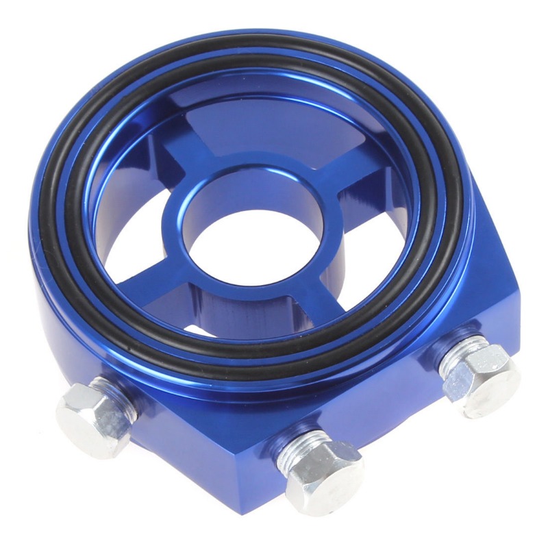

Scotch, the type of sandwich plate I had in mind is a simple one, to use only on spin-on filters, like you have now. Is it also how you understood what I said?
Here is a link:
Oil-filter-block-Adaptor-Sandwich-Plate-for-pressure-temperature-sensor-gauge
This is exactly what I bought for the Vmax, but still haven't used it. My idea was to attach this now and you could run pressure or temperature gauges directly from the filter. If not permanently, perhaps for research? It's just about $12, and I am going to do it this summer.
PS. I also like the color LOL

Sounds good scotch!
One thing sucks though - why didn't you discover it a week earlier? hahaha - I wonder if mine after sitting for years (remember the stuck rusted pistons?) would appreciate this one of the quite effective repair techniques: take it apart, clean, put it together. BAM! It works!!!
The oil pan was very clean though, things should be alright. I might grace the bike with an oil pressure gauge later on to keep abreast of things.
Anyway - congratulations so far and I hope it will stay this way! Give us an update later!
