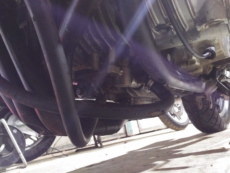

Mines a 6-1 too, see the pic on the last post (DG style but DG UK say it's not one of theirs so maybe a copy) and yes it's all pretty bulky and close to the sump and also the ground... in the condition I picked it up the two lowest pipes have been very badly crushed from hitting something, kerbs maybe, and the stupid cooler lines hang even lower as they're very inflexible.
I subsequently worked out it was on short shocks so have swapped those back to OE, and am assuming the forks springs are probably cut / dropped too for a shorter rider, but at least the front end would be due an upgrade anyway as I'm 6'2" / 200lb so could do with some firmer springing.
I'll have to investigate what the cooler & unions are comprised of, as in principle it seemed a good idea, but I'm nervous to see jubilee-clipped oil pressure lines and 'hose tails' that spin freely in their housings (albeit not leaking)!
Guess these could be circlip retained and o-ring sealed, but doesn't seem a very robust setup.

I missed the picture of the oil-cooler "Spaghetti" under that bike ! Looks like a recipe for disaster !

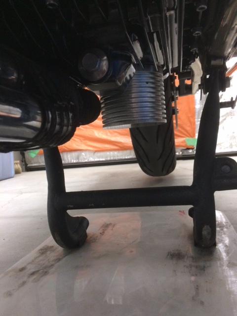

The first pic looks like a failure waiting to happen. Not sure who in their right mind would leave oil hoses hanging like this.... Looks like the bikes goes over carbs from time to time. But in the second photos I see a lot of space! You could fit there a couple of pipes and carry contraband, hahaha

Stan ! Well, shit ! You saw right through this one. Ok; It's not really an oil filter-adapter - it's a rouse; simply to get my "stash" safely from point A to point B. :evil:

so.. that first photo of of your bike scotch??? You are pulling a leg or making sure all confidence in your opinion is lost???
That first photo is savage. Damaged pipe, worn oil mickey-mouse hose, more of it hanging to get ripped off with a road debris...
I just hope it's not you.
