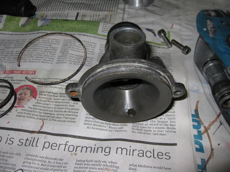

I have removed and re-attached the coolant pump housing on a number of occasions. My experience has been that as with all precision engineering, cleanliness and surfaces free from corrosion are essential to get a good seal - this is particularly the case for "O" rings - the groove for the "O" ring needs to be clean and smooth and the outer surface also needs to be free of scratches and corrosion. Having said that, I always use a liquid gasket on the housing flat mating surfaces whilst avoiding getting any of this on the "O" ring or its mating surface.
Its easy to tell where the leak is coming from - a mechanical seal leak will deposit coolant from the drilling at the base of the block whereas the "O" ring will leak around the housing - I have had both over the years.
Picture below shows my housing - needed a clean up to remove corrosion in the groove:

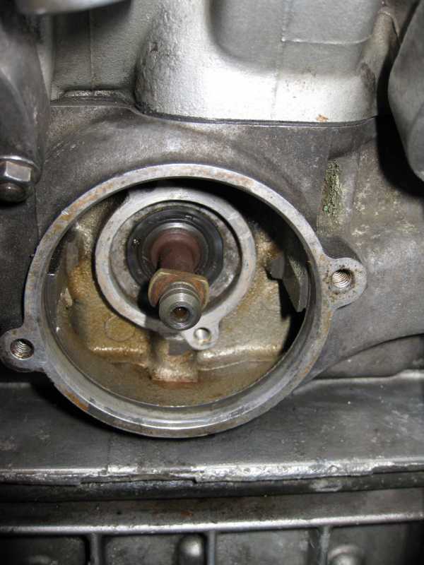

This pic shows the tunnel for the housing in the block - face and inner diameter need to be clean and with no scratches or indents - liquid gasket applied to outer face only.
