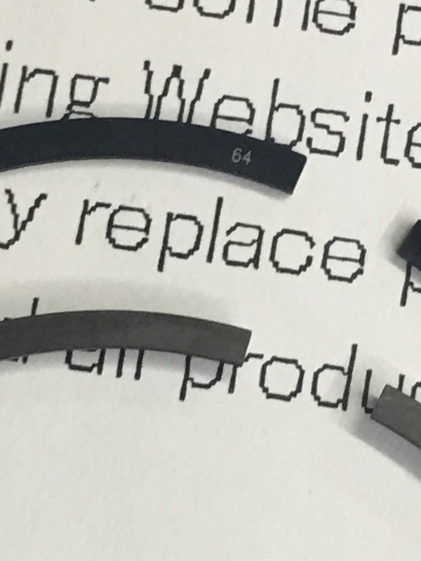

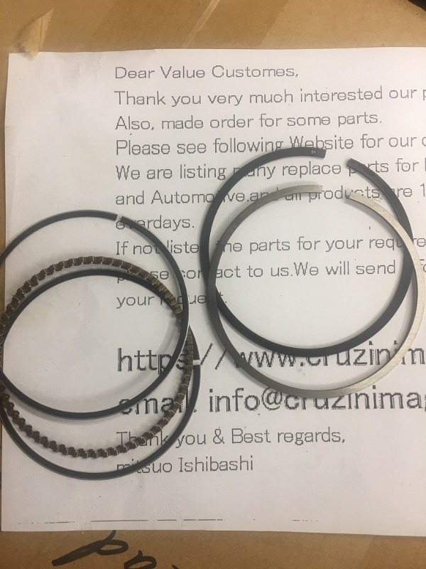

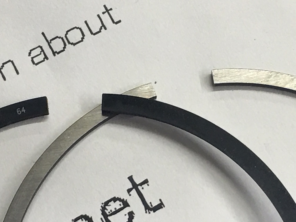

StanG asked me in another thread about the rings that came in my Crusin Image BigBore kit. I ordered and received this kit last month.
Here they are:
Here they are:

I see.. Thank you Frank833. So both have same rectangular profiles, but at least the top ring looks metallic. I think it's pretty clear how these rings are made.
The beveled profile with it's smaller contact surface is for better contact and sealing, and chrome surface to make them tough as the top ring and prevent excessive wear.
The stock size rings have none of that. I'll leave it at this at the moment.

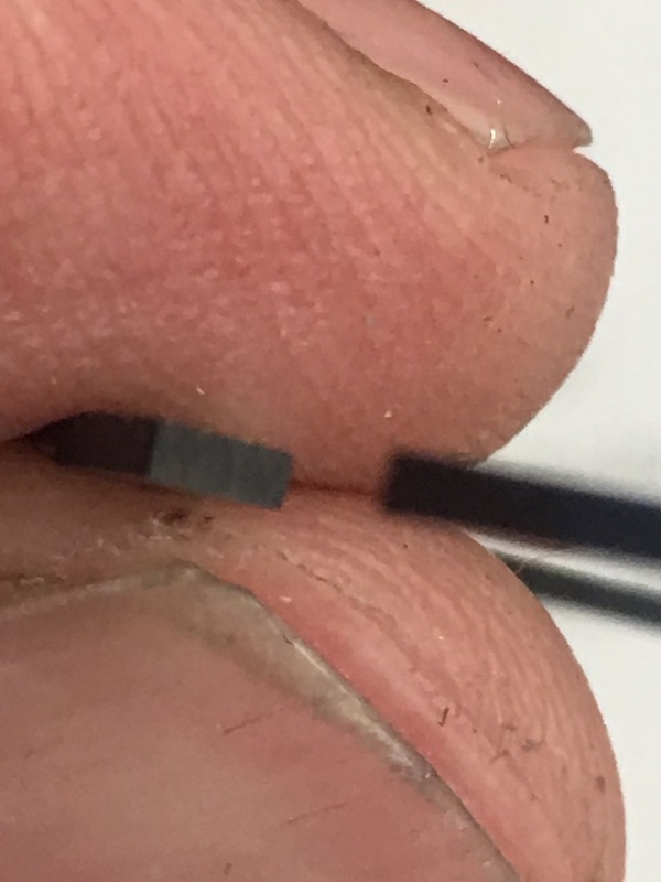

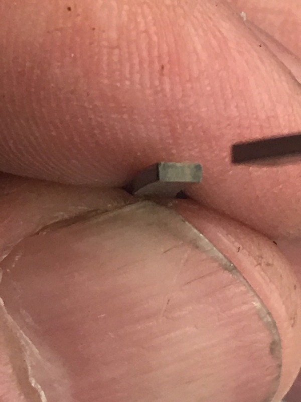

I just checked the original Kawasaki rings. There is absolutely no doubt - the top ring has a bevel (and is chrome treated), and the second doesn't.
I'm going to take a photo in a sec.
