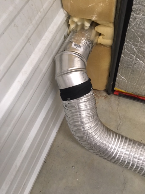

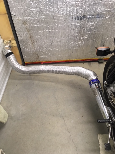

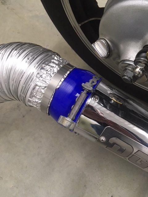

Bought a 4" X 3.5" silicone air intake adapter, a length of 4" aluminum dryer ducting and a 4" dryer vent.
Self explanatory from there.

Man, what some guys will do to go riding in the winter months and not have to get the snow off their bikes
Do you have a big screen tv in there with "Wilderness Tours" playing?
That beats the old 4" rubber hose we used at Markham Chrysler Dodge that you threw over the tailpipe and out through the hole in the overhead door. They would get so hot the rubber would start to melt and the smell........Nice work Scotch
