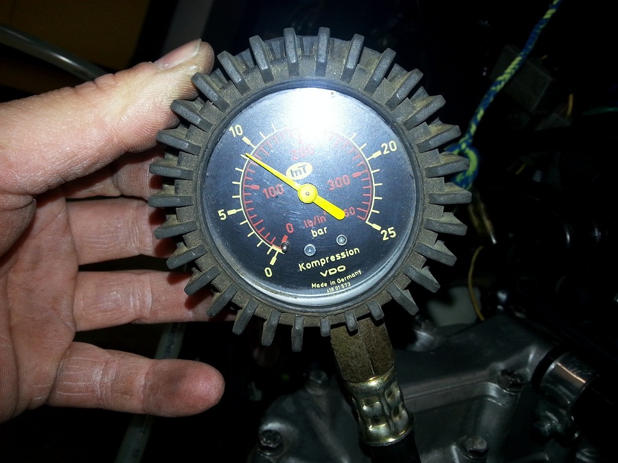

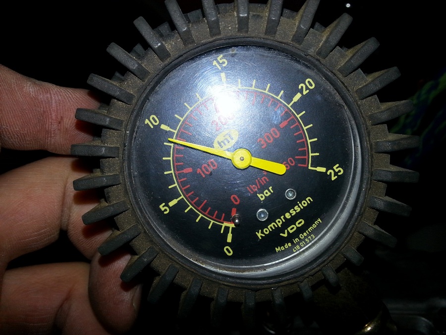

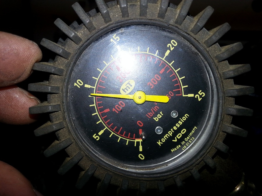

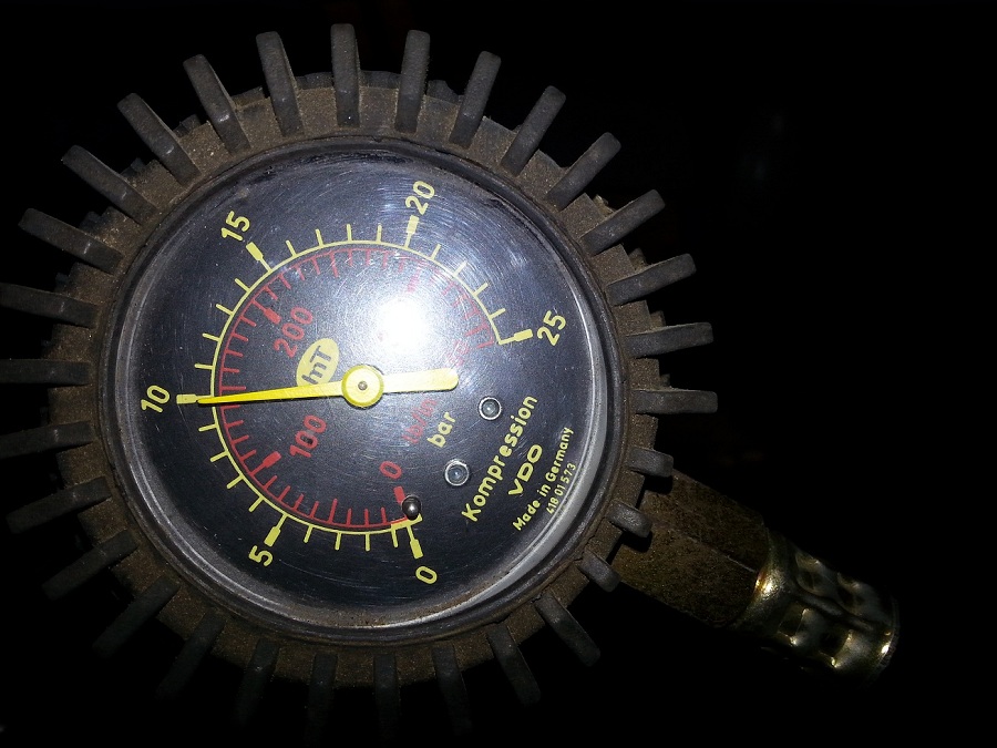

Hi I have a question regarding cylinder pressure. I have measured it on hot engine and the way the manual states. My Kawa have approximately 46000 km now, valve clearance is with in the spec and the measuring tool was compered to calibrated gauge prior to measurement. After adding some oil to the cylinders the measured value was more about 0,4 to 0,8 bar to compare to the measurement with out oil. What you guys think? I know what the manual says, but I like to hear you objective opinion what you bikes cylinder pressure look like and if anything needs to be done on my one any time soon or not. The bike starts and ride with absolutely no problem, spark plugs are all nice tan color.
Thanks Darek

Absolutely normal. The "little bit" of oil you added is non compressible and will take up space in the combustion chamber and that acts like putting in higher compression pistons. The oil also minimizes the leakage between the piston rings, cylinder walls and the piston.
Everything's fine. Go ride the wheels off of it and be happy. Burning a tan color - Tells me you're not burning any oil to speak of. Lucky You !!
