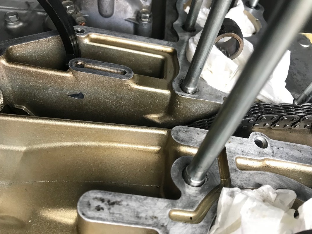

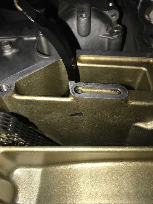

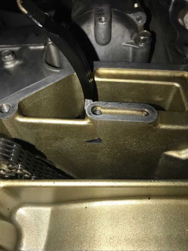

Marks from cam chain idler gear at the crank case

I also have to ask- Do I see a crack in the upper engine case ?
If you pushed the service limits of the piston (61.80 mm) and cylinder limit (62.1 mm) that would be a piston/cylinder clearance of .3 mm (.012") and that's getting sloppy. (pretty loose)
In my mind, any more than .2 mm (.008") piston /cylinder clearance should be dealt with, especially since you've torn the engine down. There's no way you can rebuild this engine now with new rings and a cylinder hone and end up with a reasonable seal between the piston rings/pistons/cylinder walls. Loose pistons in the cylinder bore will cock around and that can lead to piston ring flutter which will allow ring blow by and blow down past the piston. Blow down leads to dry cylinder walls and eventually can cause a piston seizure from lack of oil between the piston and cylinder wall. Even more so on high revving engines.

Thanks for your reply, Kawboy. No, I don’t think there are cracks (don’t give me a heart attack) I will take a better look when I get home
