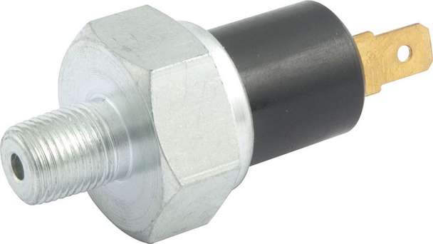

The Oil Pressure Switch is merely a pressure disc that breaks contact (OPENS) when the minimum pre-set pressure is recognised. It's possible that the contacts in yours are dirty/corroded. Nothing you can do to repair. OEM's can be pricey but any generic could be used provided the pre-set pressure rating to OPEN is within the value needed and the male MPT is the same - which is standard 1/8" MPT - I believe.
Perhaps someone can confirm, but I believe the Oil Pressure Light, goes OFF with as little as 4lbs PSI.
Something like this:
allstarperformance.com/pressure-switch-4-psi-all99058/
